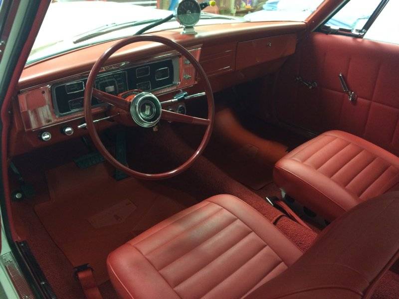

I used a small 2 1/2 6 grand autogage(autometer)on my stripper dually since it didn't come with a tach. It was mounted on top of the dash but under the overhang of the drivers side windshield post. Excelent visibility and unobtrusive. I also used the same location with a 3 1/2 Faria tach many years ago on a 57 chevy. I would use that location again absolutely. (On a side note, the faria was the best tach i ever had, accurate and FAST, but only usable with points and low power ignition, as the tach was in series not parallel from the coil. All energy passed through the tach.) Neither blocked vision at all.

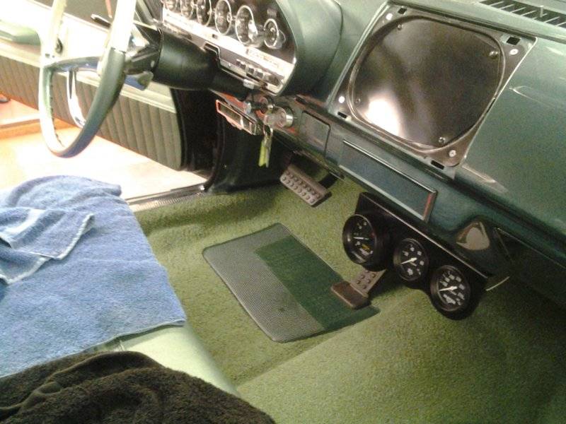

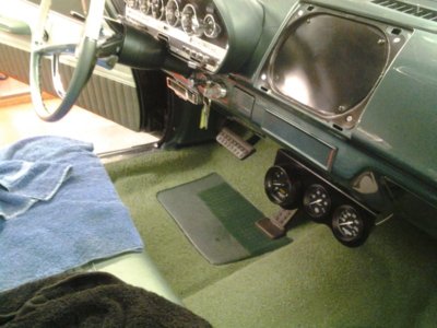

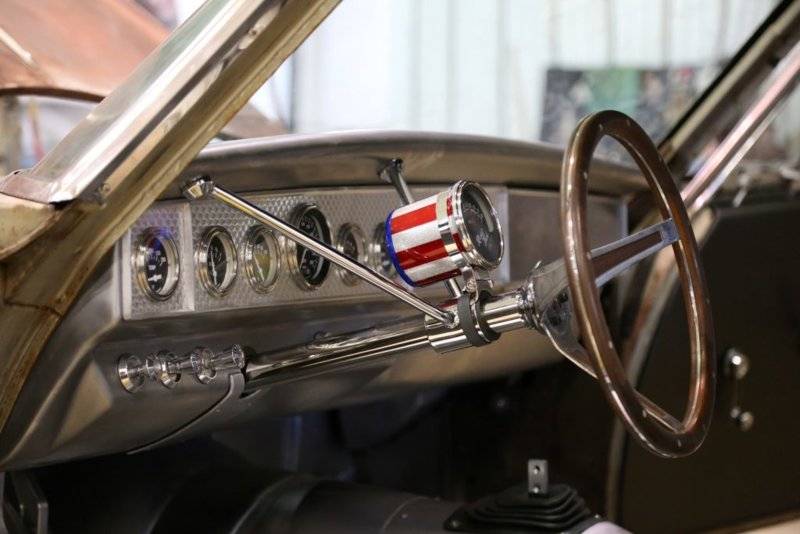

Here is what I did with my gauges on my 62 Dart. I just made a new gauge cluster mount and even used the existing holes on the under side of the dash.
20160514_090203.jpg 20160514_090229.jpg 20160514_090248.jpg 20160514_090203.jpg 20160514_090229.jpg 20160514_090248.jpg

That looks good on your car. I am thinking more and more under the dash, on the right side where i have some gauges already mounted.

This is beginning to look like the best option for me. I have three gauges already mounted in the same position as yours. I don't like the idea of looking down under the dash while I am driving, but then again, it's not like I am street racing or anything.
Yeah you do have to look down for it but it's graduated nicely enough to read it at a glance. When cruising I didn't find it hard to see, checking shift points. Makes it nice to see what it's idling at when sitting in traffic ect.
I didn't want to drill any holes in the dash. There wasn't enough room between the steering wheel and gauge cluster to mount it on the column on this '62.
Calling @Dennis H - he may have pictures of the "Galen Govier" approved mounting kit? :D

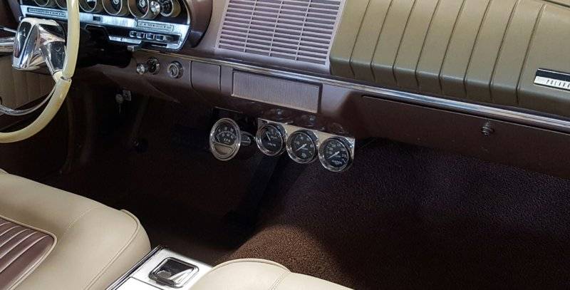

Something I've been contemplating also. I dig the way the Roadster Shop did JJ's 64 Polara and wouldn't mind doing something similar looking, but much smaller scale (I don't need to support the stock column). Just make some kind of tubing that attaches the lower edge of the rolled part of the dash to mount the tach to.

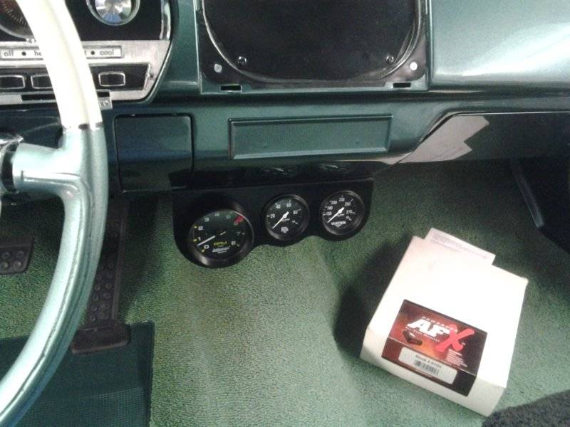

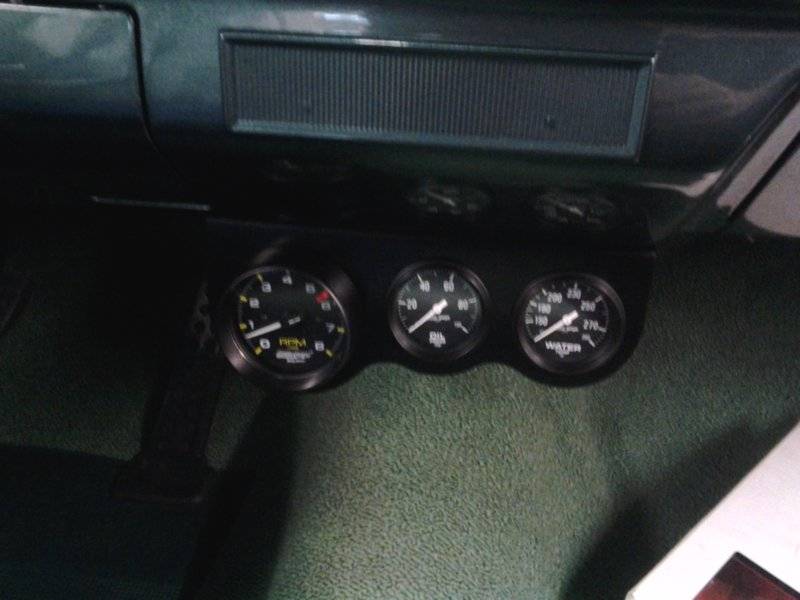

Put a Dakota Digital instrument cluster in it. Tach will be in-dash, visible and won’t obstruct anything.
That looks nice, out of the way and still get the job done. What type of tach, gauges and mounting bracket is that?
We just made the gauge panel for the tach, temp, and oil pressure gauges. The gauges are Autometer classic. When making the mount don't do a 90 degree bend we ended up with a 70 degree bend.
