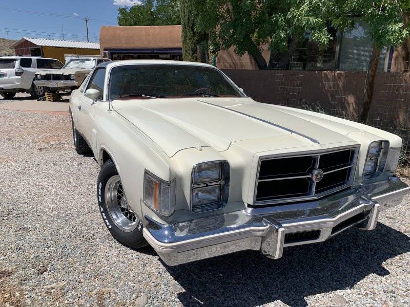

I have 17" X 8" Year One Rallye wheels with 255/50-17 tires on our '77 Cordoba and it has plenty of room--so much room I wish I would of maybe went wider--at least in the back.

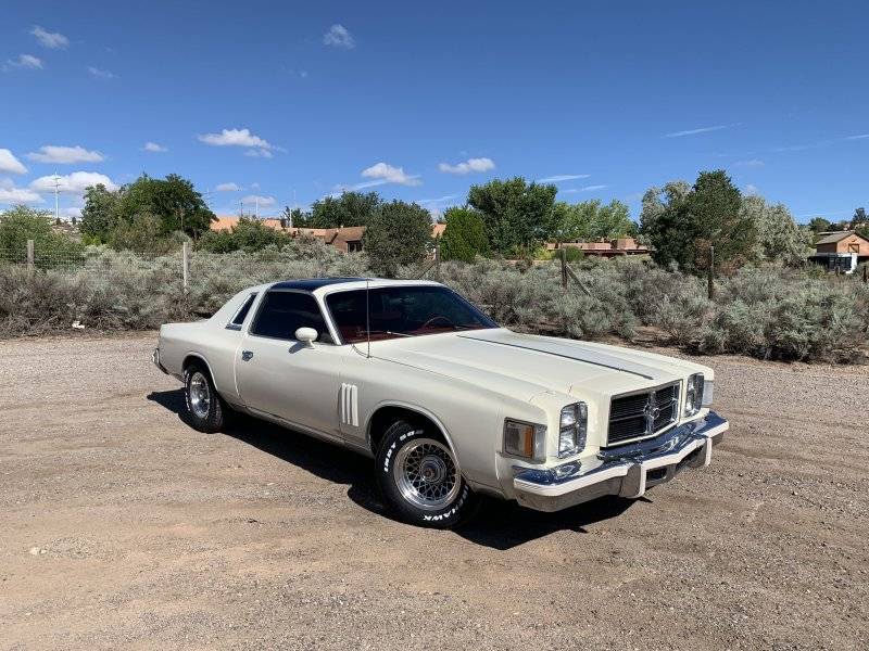

255/60R-15 mounted on 15" x 8.5" on all four corners. Been running them since late 1983. No rubbing anywhere; ever.

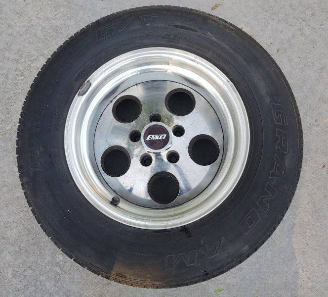

I got these from Jegs but are no longer made. If I had known I would have bought 2 more sets.

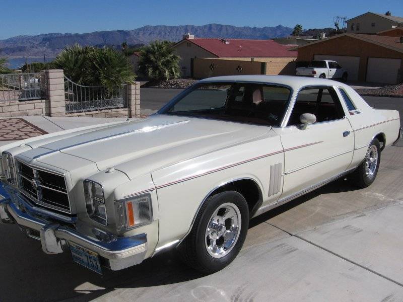

Was always a fan of aluminum slots. 15x7 225/75/15 front 235/75/15 rear. Should have never sold the car.:(
