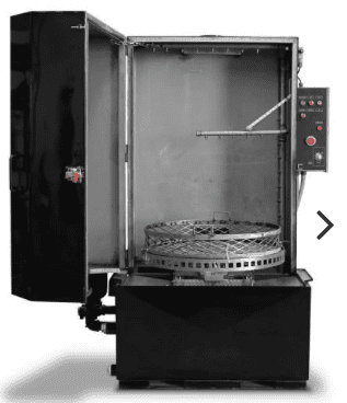

By "Parts washing cabinet" are you referring to a solvent tank? Or a powered parts washer like
Cause the latter is a nice thing to have but hard to justify for a home shop....
