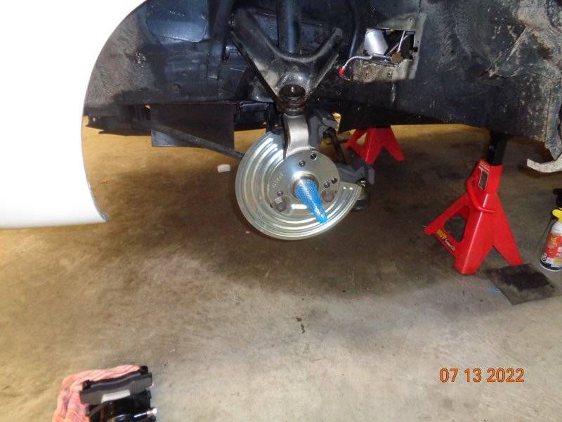

This is how I support my Mopars. Jackstand under the front subframe rails. This was my 64 Fury as I was doing the disc brake conversion. I was able to use the floor jack to position the LCA as needed for removing the lower ball joints, as well as supporting the new assembly as it was being put back up into position. Made life easier for me.....
