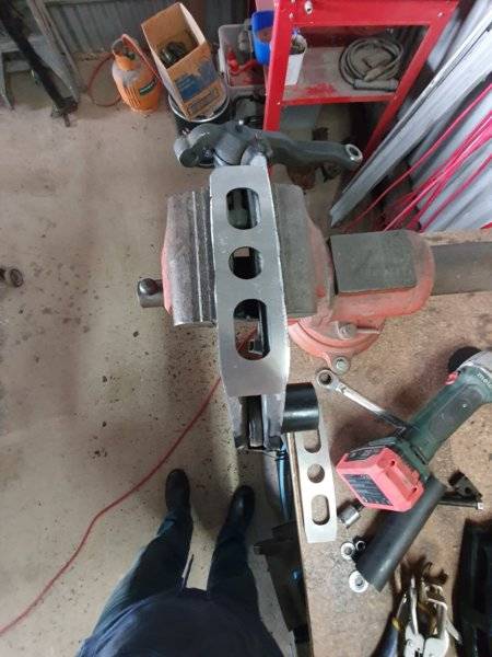

i did have a r&p kit but i have removed the kit and back to standard, it has 2"drop spindles for now, i recently replaced uca ball joints and rubbers, new drag link, idle arm, and ball joints, the lca are standard, but like i mentioned they seem to be flexin/moving, who knows what life they have been through before i restored the car
It will more than likely be the LCA bush that's allowing the movement. They can be replaced - it's reasonably difficult for the average home mechanic but will make a world of difference. Search the internet, there's plenty of good articles on replacing them. Good luck my friend.

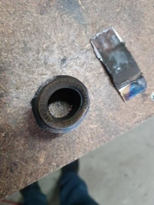

This is how my LCA bushings looked like...car was all over the place.

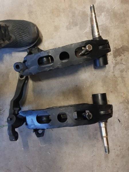

Also when you do the LCA,get the plates and weld them on.No issues with my 71 but seeing how everything was apart for full rebuild, i went and had them welded on,big difference on corning.good luck .

Good job!
That bush does not look that bad, but for sure takes care of some weird surprises during cornering.
And with the reinforcement welded on it will be a solid drive again!

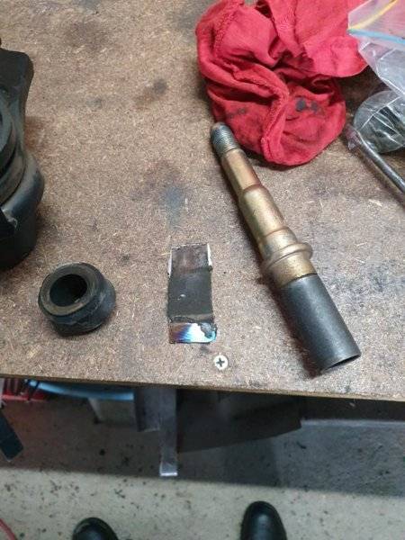

Did you use new pivot shafts? Looks like it.
I reused mine as there was nothing wrong with them but then found out the LCA inner steel bushing was not tight on the pivot shaft and could slide off by hand. (should be tight)
How are your pivot shafts? Solid secured inside the bushing?
