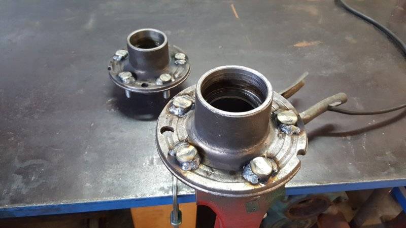

I had to have my hub replaced a few years ago, which included new studs. Something about the originals needed top be cut. Anyway I had to take the tire off the car and all 5 studs just spun in the hub. Finally worked it off and the shop I had do the work also installed the wrong studs to begin with and stuck a spacer behind the wheel so it would torque down. Tried the "correct" dorman part from orielly auto just to find out the spinning wore out the hub too much so I decided to try one size bigger in the knurl.
I am having a hell of a time doing any kind of machining to the hub to get the new studs to press in. Just can't get the material down to open the hole enough. I was able to get one hole close, but still can't get the knurl to press into the hub.
What is a way to work with this thing so I can get the wheel back together? The suggestion has also been brought up top get the "correct" ones that fit loose and tac weld them in place. I'd rather not, but at this point im tempted.
The lugs on my driver front are tach welded in place. I don’t like it but was in the same predicament you’re in. It’s been a couple years and no issues
I found that the knurling on some studs weren't uniform. Ended up with some tight, some were loose fitting.
Look at the top one and you can see how uneven the knurling is...
Break out the welder...
Girling english disc brakes, with the required 3" studs on the front. Studs were close, but not close enough, so tack welded. No further problems.
Just went through that two weeks ago. Put a small tack weld on the wheel studs.
If you look at Rock Auto, they give the knurling sizes for the various lug studs....and there is quite a difference in sizing. I bought new studs for my truck, and they were a perfect interference fit.
I have 3 inch ARP studs all the way around the car and they are tack welded.
I had the same problem on one or two studs. I was going to tack weld, but decided to try Permatex (red) thread locker. So far, so good, but if it fails the welder comes out.

Yeah, I just noticed I never updated the post either. I ended up getting the ones that had a slightly smaller diameter and welded them in place. So far holding together great. I tried all 3 sizes that showed up on the Napa guy's computer and none fit quite right.

I always solved that by drilling/reaming the start of the stud hole a little, and grinding a little of the knurl off until I could press the larger ones in. I also try to use only black oxide studs, years ago the plated moroso ones were shearing off.

If it was my vehicle, i would use the TIG setup with argon/helium shield gas and using ER70S-6 filler metal.
