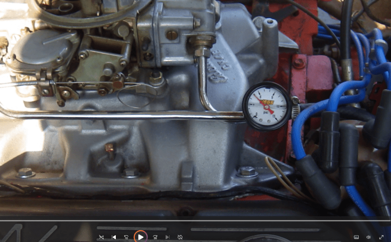

FWIW, a capture of a video @ idle after installed a while back......................if you choose to trust a Jegs gauge :steering:.....
