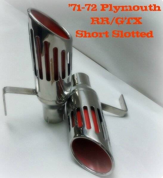

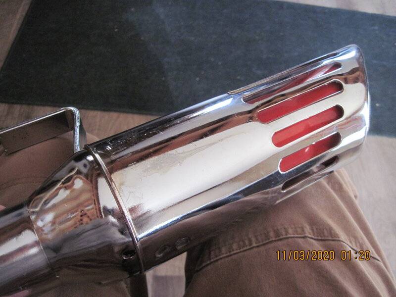

1971 & 1972 Plymouth took the short tips and the interior is a hemi-orange color. The 1973 & 1974 Plymouth and the 1971-1974 Dodges utilized the long tips. These were also hemi-orange. The resonators and their associated tips were only utilized on 1971 hemi cars.

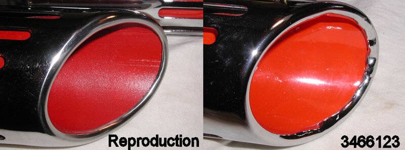

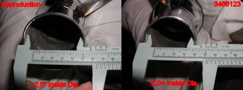

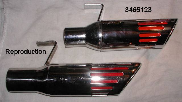

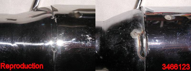

Here are the pics I downloaded years ago from that site and others.

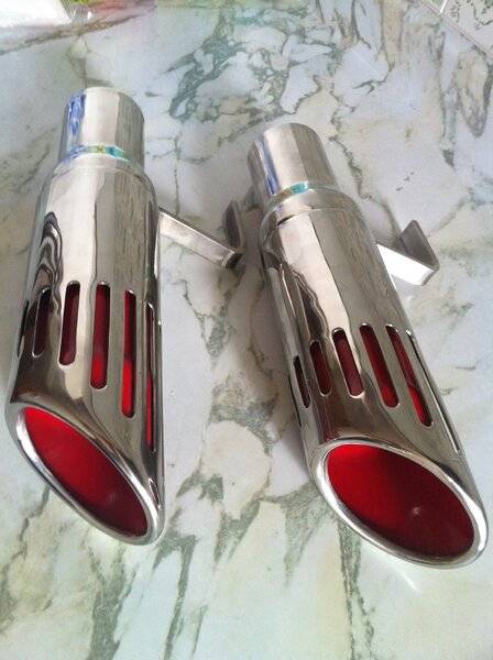

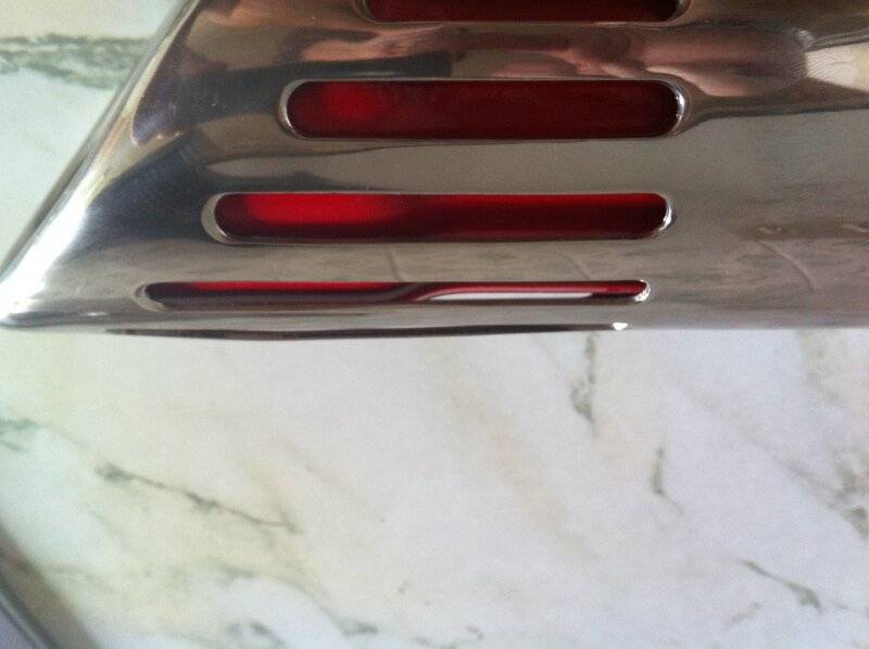

Never thought these pictures were to be used as reference LOL. Those are the repros I bought from PG Classic and that's my kitchen table in Venezuela. Way overpriced, the inner tube is not the correct shape ( it should be conical, and not a regular tube stretched to meet the outer diameter. AAAAAND the paint didn't hold. It took me 1 week to burn them and get them black. They are SS and 2,5"

I think shorts were Plymouth couldn't tell you color
All red. I wouldn't say Hemi Orange. Is the same red shade use on the MAGNUM emblem. And well, sizes are already posted... around 13"-14" the longs and can't recall the short version. MAYBE 9" or so?
Black version is a reproduction market option. I guess because all become black at certain moment? LOL, and decided to offer them in black from the beginning LOL

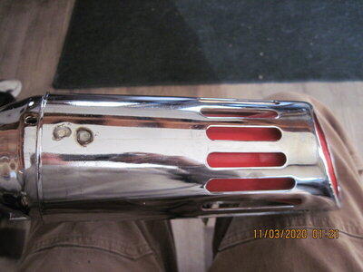

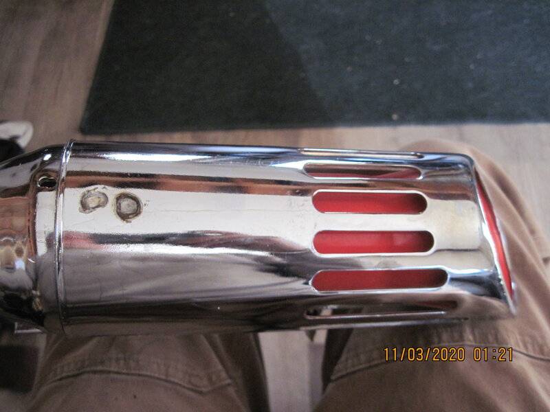

Black ones came through dealerships and I have seen many NOS versions of Black instead of orange...
