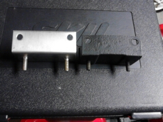

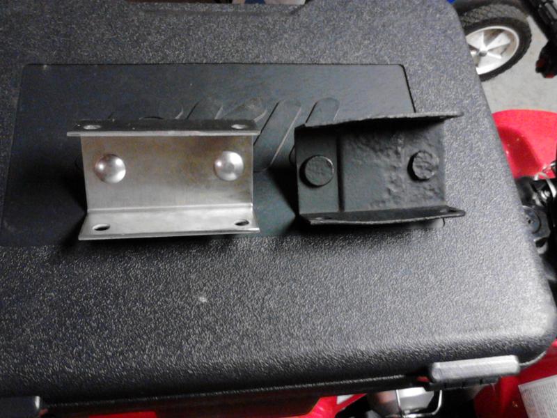

made my own sway bar frame bracket from 12 gage stainless.
callofthemopar
12:24 AM
Jan 3, 2013
176
119
northern KY
I needed the C shaped rear sway bar frame bracket for my 73 charger due to one of them being rust dust, I measured it and all holes in millimeters and formed my own from 12 gage brushed stainless. I then heated the bracket and rounded the square shoulder of a carriage head 1inch 5/16 stainless bolt to just over the size of the puched out 5/16 hole. I froze the bolt and slipped it into the heated bracket. When it cooled the bolt was solid enough to tighten a nut on without turning itself. This replicated the orignal bracket.
I have made a couple more sets if anyone is interested.

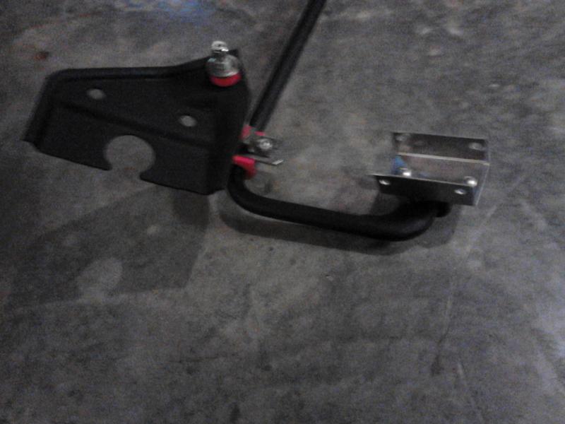

stainless sway bar frame bracket pics.
Ok, I think I learned to post pics.
Nice.
Thanks.
congrats...LOL.. & the sway bar mount looks good too

I would like to see what you did on the link to sway bar plate. Is that also something custom?
Yes. I have been tinkering with that. I will not know final fit until I get it mounted But I will post a pic. of what I got so far. I have to get new U-bolts for the rear to be able to mount the bar.

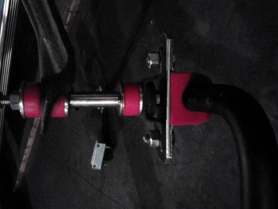

This is what I have so far. I will probably shorten it for ground clearance. The poly bushings & sway bar links are off the shelf from autozone because the originals were junk.
Not bad man, they look shorter than the ones I am using from Firm Feel.
