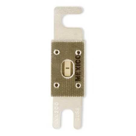

I org. had a 100 amp flat fuse before I went to a breaker
we use to use them a lot in build areal equipment on trucks
there're like $34
but at that amp. it's take a big short to trip it,
the breaker is actually cheaper too...
Done the resettable breaker style since 1997 so far so good...
I used a 100 amp flat fuse that I purchased at my local NAPA store.
thanks for the info guys. I am putting this one right after cut off switch. I think it will do the job.
Many starters will draw way more than 100amp. Even our new inline alternator fuses are 200 amp. Working in the electrical lab at Chrysler we test this stuff every day.
