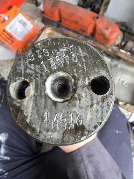

I'm working on a 440 right now that I'm going to put in my car.
I decided to pull the cam so I could see if it had a stock cam or something else put in it.
The cam says Manley on the front but it's stamped with multiple numbers on the back of it.
Can anyone help me try to identify which cam it is and the specs?
Measure some lobes, and surf around for an old catalog
It looks like the #17616. Single pattern 300* adv, 236 @ 050, 480 valve lift. 42-78/78-42
