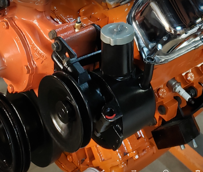

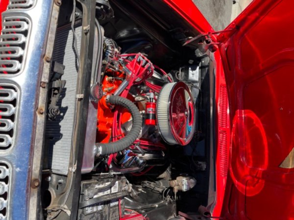

I recently converted my '62 to power steering from a manual. I really like it.
