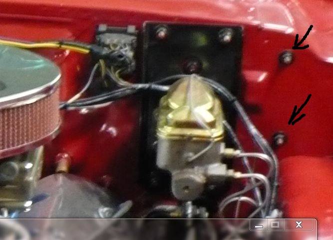

Will this unit # 2225621 fit a 65 Coronet, They list it as a fit for a 67.
Car has disc front /drum rear. I put the wrong MC on during restoration.
Actually, the taller unit , illustrated first , is the
1967 - 1970 Front Power Disc / Rear Drum Master Cylinder…

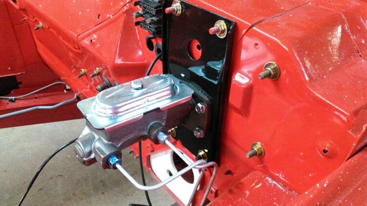

The second one illustrated is the
1967 - 1972 Four Wheel Drum Brake Master Cylinder….

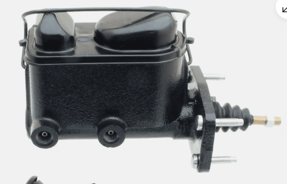

The third one , in Fran Blacker’s illustration , the shorter , squattier Master Cylinder , is the
1971 - 1973 Front Disc / Rear Drum Master Cylinder…..
