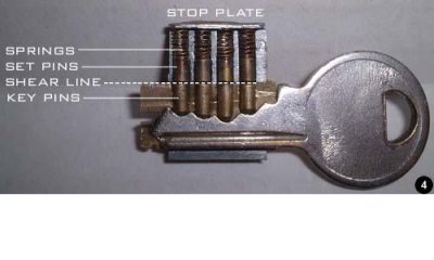

A good ols locksmith should easily be able to do that. The insides are not at all complicated. There are usually 5 or 6 slots or holes each has a pin in it each of varing leingth, simply put the same leinght pin in the same position on all 3 locks and they are now keyed the same.
10 minute job. Mopar door and trunk locks are real easy to rekey...unless you don't have the same pin lenghts, or there is a lot of wear.
