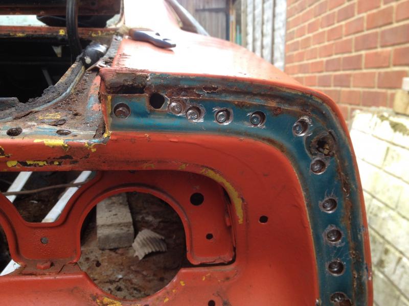

Well I've finally started work on my Charger after owning the car for nearly 6yrs.
Most panels seem to have some rust and there have been some not so good repairs made to the rear quarters.
The corner pieces between rear quarters and valance are just bondo.
I'm only working on the car for a few hours each weekend so progress will be slow but at least I'm getting on with it now.
I've started drilling the spot welds on the tail panel and rear quarters.
I need to remove the rear screen before I can go much further. I didn't fancy my chances of getting it out in one piece today as the car is outside and it's pretty cold. I'll get it done soon. If not tomorrow I'll make it my first job next weekend.

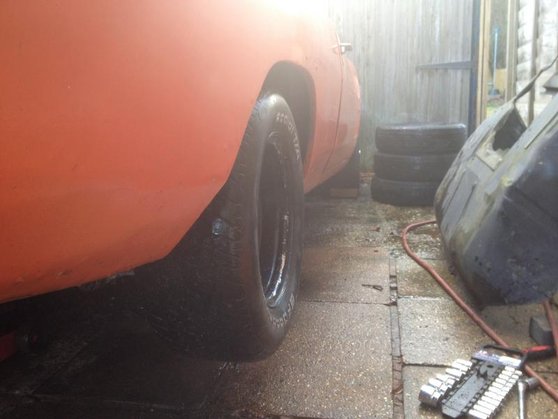

Here's some pics taken with my iphone:

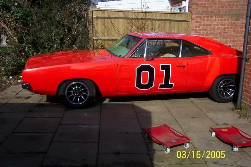

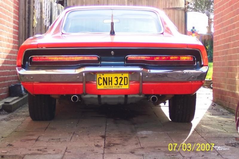

I did most of the work on my old Charger on the drive (see pic) although I sent it out for paint.
I reassembled it on the patio!!

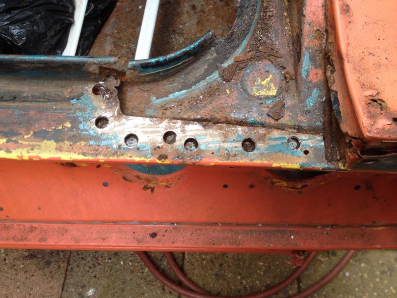

I got about 2hrs in on the Charger this afternoon. It's very cold and windy outside so I didn't get much done.
The rear screen is out and safely stored away.
I need to remove the filler panel, drill out a few more spot welds and then I should be able to remove the drivers side rear quarter.

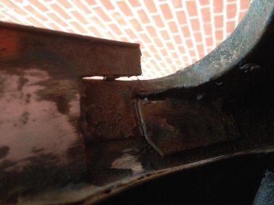

There's one spot weld though that is a little tricky to get to. It's the one in the rear window opening where the drip rail is spot welded to the quarter.
I have a right angle drill attachment but can't get the spot weld cutter square onto the weld.
Whats the solution here? I might try and drill it tomorrow but if that fails which I think it will I'm guessing I will have to cut around this section and drill the spot weld when the quarter panel is removed?
Is there a better or easier way that you guys would tackle this?

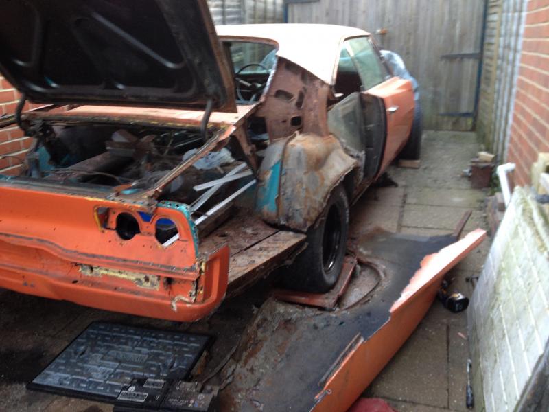

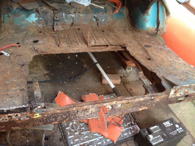

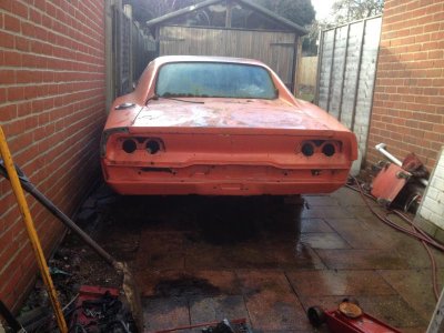

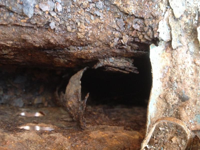

Quick update of where I'm at now.

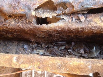

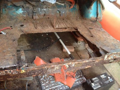

Quarters, rear valance and tail panel are off.
I was hoping to repair the rear frame rails but after removing some of the trunk pan I can see they are toast and new rails are the only and best way forward.
I'm wondering if Goodmark rails will work with the AMD trunk pan that I already have or if I'd be making more work for myself should just buy AMD.

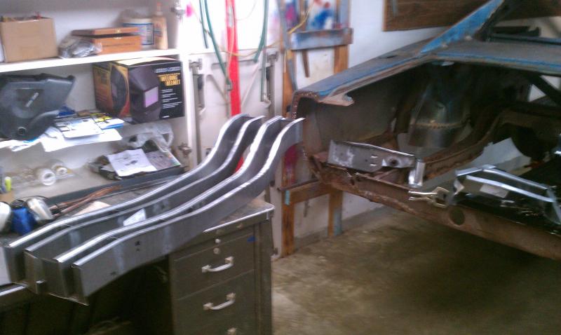

I assume you know they make partial rear replacement rails. My rear rails were shot also but they were not rusty from the hump frwd so the partial rear rails worked great, for me. They spliced in at the center of the hump over the axles, and you really can't tell that they've been done if you do them carefully.

yeah I can get the partial rails no problem but am unsure about splicing them in. Obviously I have to make a very strong joint here. I would like to know the best way of doing this. Are they butt welded with 100% penetration or is any further strengthening on the inside of the rails also needed.? I was thinking that if I make a jig I can ensure that the new full length rails are installed in exactly the same place as the originals and may be a more straight forward install. But on the other hand partial rails would save me some hard earned cash.
Has anyone done a detailed thread on fitting partial rails?

personally I would use full rails, JMHO.
The price difference isn't that much and depending on your welding skills..........
That's what I have are full rails, it is easy if your floor is good under the rear seat you can just drill out the rails and reweld the from the top

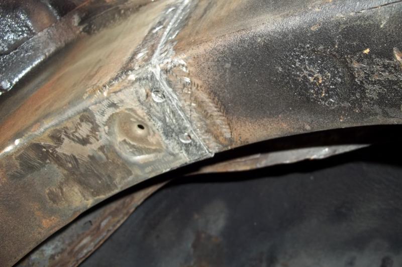

Full rails are the way to go if you can but the 1/2 rails like Daytona shows are good and they will work great, they have a lip all around and they slid into the original front portion, and drill a few plug weld holes on each side and the bottom (original rail) you just need to get them squared and level, measured right and weld them in, After you weld them in go down the seam where they fit in (new with original) and weld that and you can put some weld inside the top if your trunk pans are out, they will be good...
Hope you can see this good enough.. Shows the plug weld holes, and you can see the seam where they mate up you also weld...
