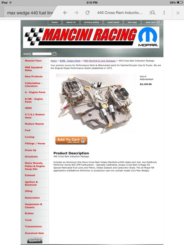

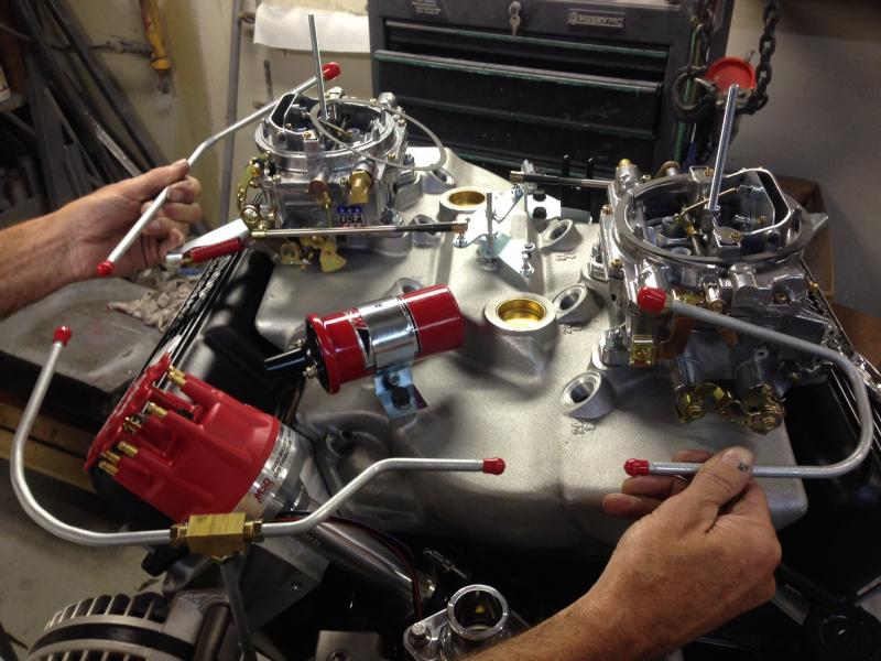

Hi,Got a cross ram intake for a 440 Build. 2- # 4305 Eddy carbs( I'm sure that the #for carbs! Got a fuel line kit for it, but it seems wrong, Think I need the set where the 2- filters are side by side coming up roughly centre of intake. Got all this from Mancini and think they sent me the wrong set, Got in another set but its the same as 1,st ?
2,nd pic is what I have and is not going together
1,st pic is what I think I need

It looks to me that the line coming off the pump is short and you have the T on wrong. I have an idea in my head, but hard for me to explain. Looks like your left line off the T should be removed. Then that part of the T should go to the pump line.
There are two different sets af lines, one for the 3447 (early MW ) and the other for the 3705 ( later MW ) carbs. Fuel inlet is different location on the carbs. You most likely have the lines for the 3447 carbs and need the one for the 3705 carbs.
Thanks 63 Fury, is that what you have. ( the later set)
I have an early MW, the same as the set you have now. The 3705 carbs came later in 63 with the stage II, and were also used on the stage III.
