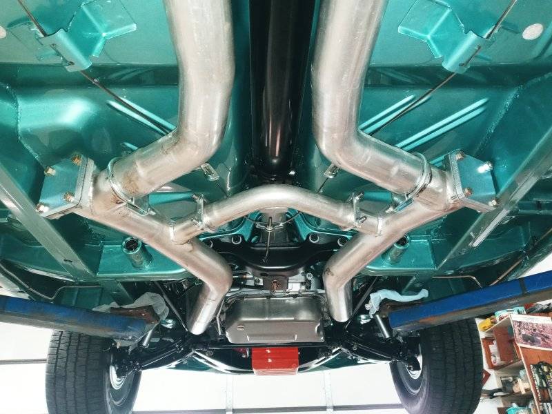

The c/o's on my '63 are going to need some fab work, as the frame ties are limiting the out tube clearance. I'm gonna contact TTI over the winter, and try to buy a pair of their flanges. I'm planning on electric cutouts, so I'll probably flange the outlet, to match what's needed ? Open to suggestions on this also ???
Wow, that is awesome BUT the frame stiffeners are really tight to the outlets aren't they? I'd sure think the only way to handle this one would be to do as another suggested and add an extension to the outlet. But, the bend is going to be pretty sharp. Darn. It'll be kind of tough no matter how you do it.

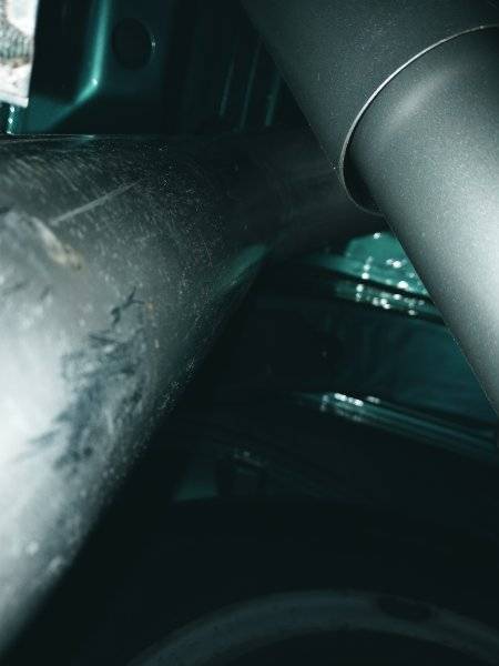

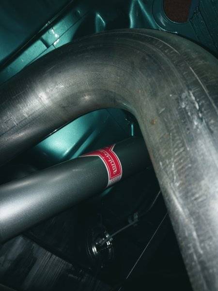

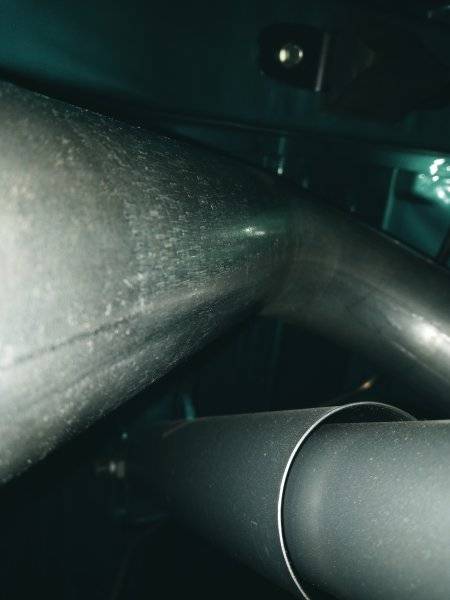

If you don't mind my asking did your TTI tailpipes clear your rear shocks? I noticed my shocks were beat up pretty bad by previous owner and after replacing the mufflers and the shocks and setting the car back on it's wheels the tailpipes are actually sitting on the new shocks and I am not sure rotating the tailpipes will give the clearance needed? Might have to take a hammer to the tailpipes to make it work
I'm out in the garage now, looks like they have plenty of clearance. I can get better pics when I raise car up if you need them.

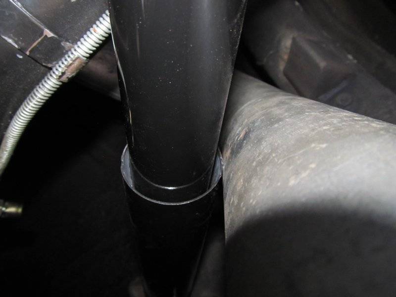

View attachment 1379702View attachment 1379703View attachment 1379704
Thanks. Obviously there is something wrong with the previous TTI installation. If I rotate the tailpipes for clearance then the tips won't point down. If I move the tailpipes to the rear they will hit the pan below the bumper. This car sits lower in the rear than in the front and I wonder if rear springs are the issue?

Just had a thought .... are the left and right tailpipes bent differently or labeled in some way on the TTI exhaust? I wonder if previous owner got them mixed up if so?
It looks like the tailpipe needs to move towards the rear of the car to gain clearance, but if I do that the outlets will be hitting the panel under the rear bumper for sure.
Any ideas appreciated. Might also be able to rotate the tailpipes to gain clearance but then exhaust tips won't point straight down.

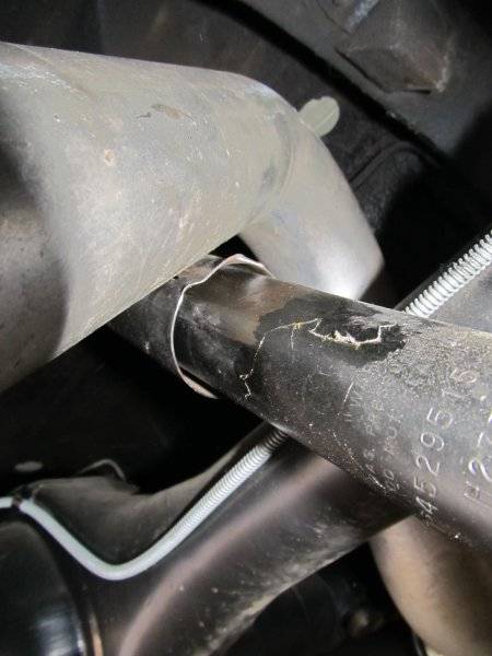

Here is the passenger side showing the rear shock condition the way the previous owner was driving it. Must have sounded awful when hitting bumps.
And here is the drivers side with a new shock installed. Exhaust tailipe is actually sitting on shock when car is on the ground.

I have a 1962 Savoy I'm getting ready to get on the road for this summer. Just had the floor replaces and sub frame connectors (US Tool) put in at the same time. After seeing this thread I was bummed that I would not be able to use my factory exhaust that's waiting to go on the car, because of how the frame connector rails would be in the way of the exhaust. Esp. after seeing VanDans photo above. His are close and the front of his connectors are installed wide, mine are installed closer together inline with the front rails.

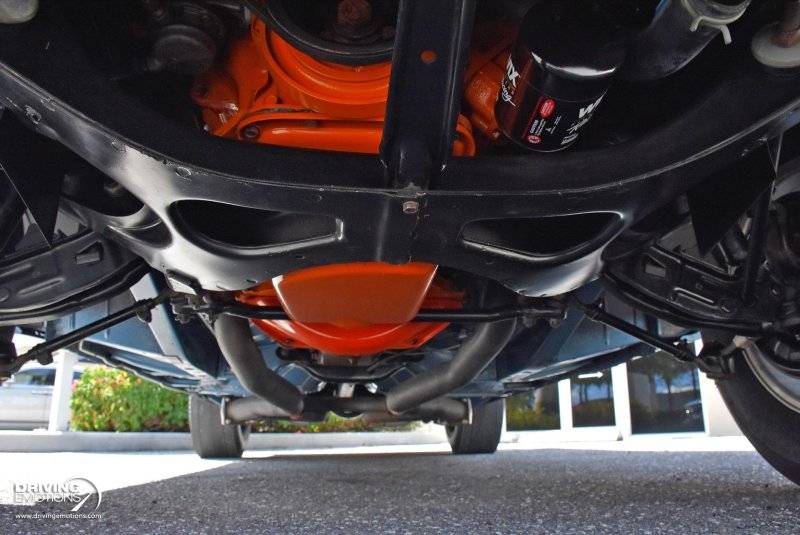

Fast forward to this morning and I see this photo of a this max wedge car and how low the center/middle of the exhaust sits. I'd be OK with installing this way.
I also see that this person s using square flange mounted electric cutouts. Anyone know the make?
Another angle that shows how low the exhaust can be mounted
