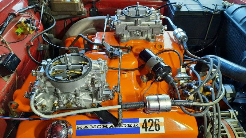

We know we have a vacuum leak on our 63 Polara 500's intake so have got a gasket set ready to fit over the next week or two but are wondering what type of seals are supposed to be used under the 6x access hole plugs... can anyone here advise what's best to ensure they don't cause a leak too?
We bought a set of fibre washers which don't appear to be working. We've seen some for sale that are nylon - I cant see them giving a very good seal?
Nick Panaritis on his Nick's Garage YT video of him assembling a 440-based MW engine used what he called gaskets, but didn't say what material they are. He did stress that they are vital to stop vacuum leaks so must have worked for him.
Do they need some kind of non-setting thread sealant?
It doesnt help that on at least one, the top surface of the manifold where the plug goes in, isnt very flat nor parallel to the underside of the plug, when screwed in :rolleyes:
NB - we've just had the carbs refurb'd with new spindle bushes so we're pretty sure there's no leak there.
Grateful for any advice, thanks :thumbsup:
