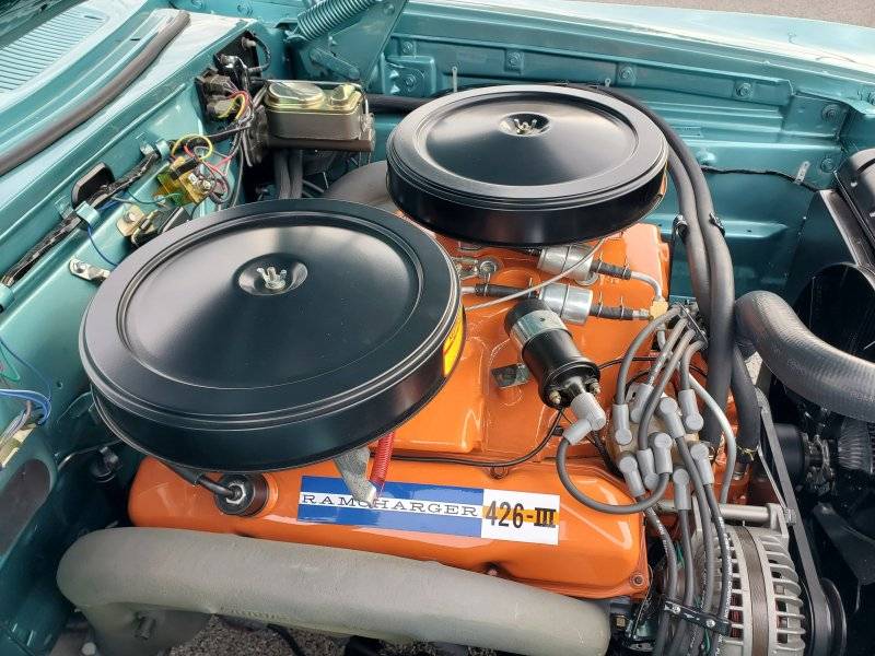

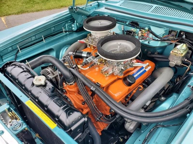

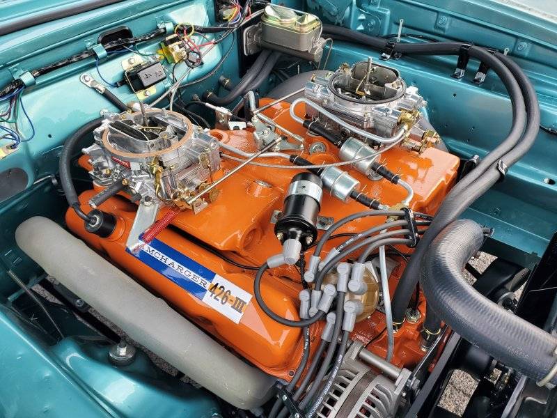

Not sure if these will help to determine clearance ? This is a '63 sedan, and newer dual pot MC...

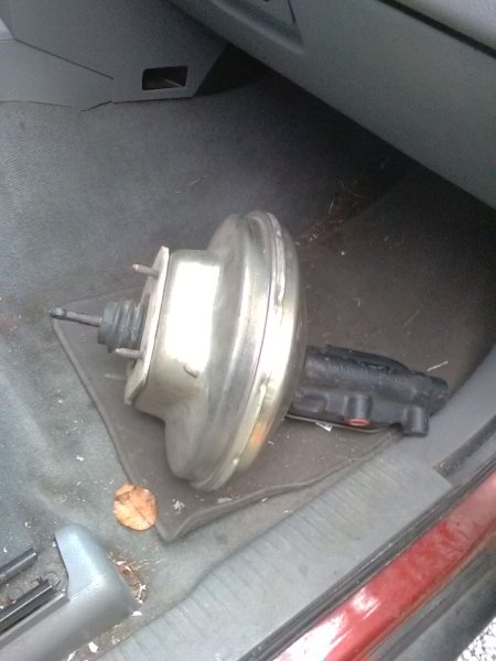

You might be able to do it, if you use the raised bracket and master cylinder used on Hemi cars with power brakes.
There was also one used on 70's A-bodies that a friend of mine used on a 383 Dart he built...
the dart was a power brake car to start with.... but looking at the pic looks like it ain't going to happen.
It will not work. Even when my buddy had Max Wedge manifolds on his 63 Sport Fury with manual drum brakes. The manifold was so close to his master cylinder that he had to make a heat shield. When he converted it to front power disc brakes he had to remove the Max Wedge manifolds and put on some 68-70 h.p. manifolds.
