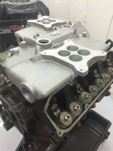

I'm currently putting a '63 9-passenger wagon together with a 426 Max Wedge Super Stock version engine with complete crossram intake and all.

A "complete" Max Wedge set-up is NOT going to be a good streetable/cruiser. They were made to race, and will be a handful under normal street/cruising conditions.

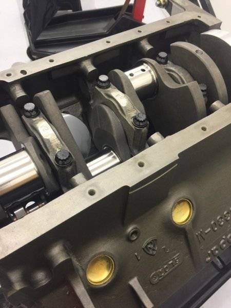

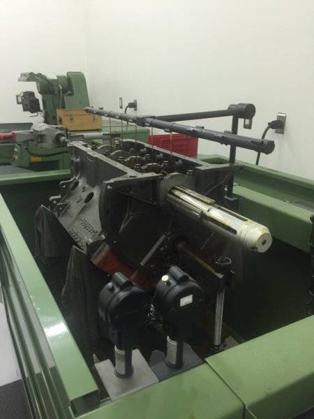

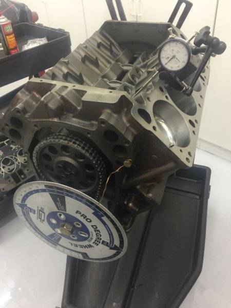

I'm working on mine now, so I'd be glad to share some info with you. My engine should be fired up in the next month or so, and we will be determining what we'll need after the dyno runs...
I have a Friend, that did 35 yrs as Chief Engine Bldr, for a Very Well Ranked NASCAR Team. He's retired now, and does some work on the side. We're expecting a Very Stout build, that's streetable, but will melt the tires off, when needed...

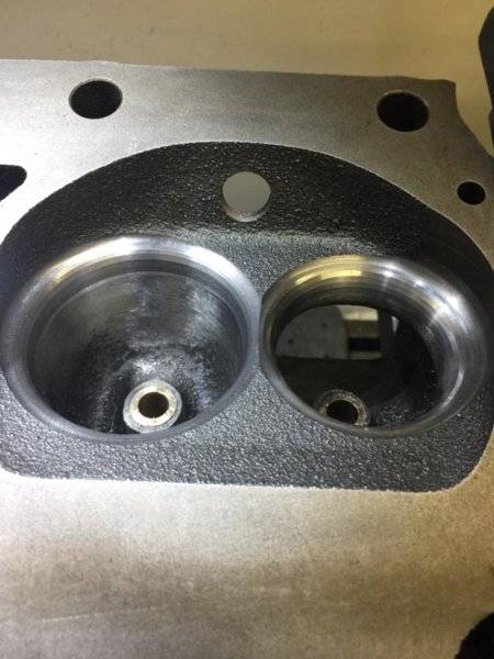

and porting the head for the street would be much different according to my porter- lots of oem heads have been ruined by the bigger is better procedure
if you are not spinning it up then more cu in would help use the heads but you're past that
we were limited to stock style valve job- today's would be much better may take new seats- I recommend the premium dura bond ones- used to be made in WA till dura bond bought the CO

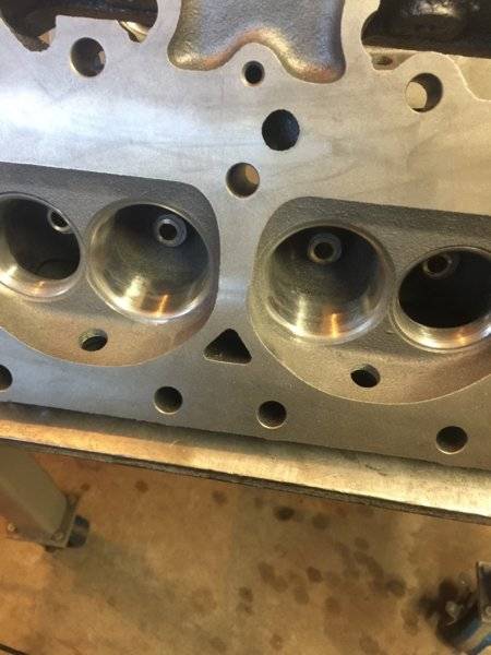

post up your head flows down to ..050 b4 consideering a cam for a street build

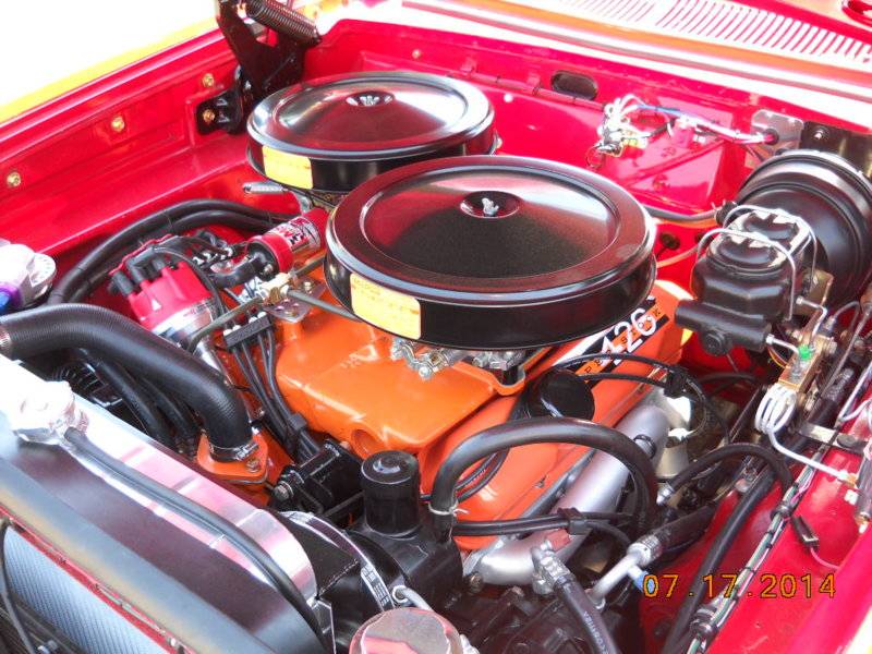

FWIW, thousands of very happy street miles. Max wedge set-up with a couple of exceptions: Slightly larger cam, 10.2:1 compression and an MSD distributor. I hear all about how bad max wedge combinations are on the street and have to wonder how many of those posting have ever had any first hand experience with this engine verses regurgitating old myths... Yeah, I know, I added P/D/Bs and P/S so my 5'3", 110 lb. wife can drive it.
The eng in my 63 may be a bit nastier then your build as I run a solid flat tappet cam that's 264 & 270 @ .050 with .585 & .592 lift and a 110 LSA. I drive it on the street a lot and race it a few times a year. I run a Luppo Dynamic converter thats been in my car about 14 years since June 2006. And I love it as it drives like a normal converter and then works good at the track. Good luck with what ever brand you decide on. Ron
