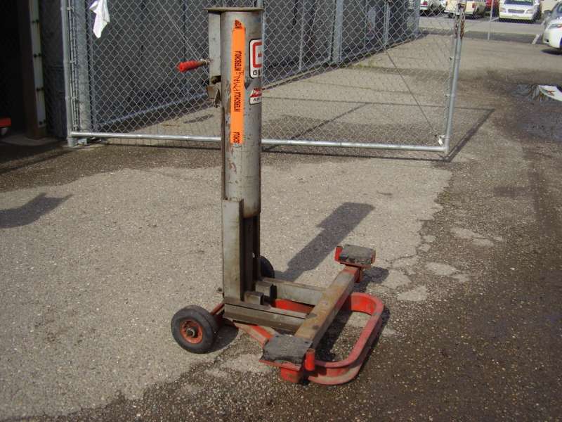

I have a Gray "air jack" that I bought from a guy who had it sitting outside for decades. It still works, but I intend to refurb abd repaint it. It allows you to raise one end of the car by the bumper, put stands under it, then do the same for the other end. I'f you're brave and careful, you can do one side at a time too. I'f you're just changing wheels, there's really no need for stands, as it has a ratchet stop.
This is MUCH faster than a manual jack on one corner, and doesn't require nearly as much stooping/squatting. I have mine up on 4 stands as high as they will go. Gives me enough room to have my arms fully extended if I'm underneath it, and brings the drums and rotors closer to eye level.
I stole mine for $100, but I've seen them at swap meets and on c/l for $250, with much nicer paint.
My brother tried to tell me he's seen "too many" bumpers get trashed with them, but I operated one almost every day as a 17 year old on other people's cars, and never damaged a single one.
On the other hand, I HAVE seen lots of damage caused by ramps.
You could buy two for 1/4 the price of that lift, and keep one on each end of the shop.

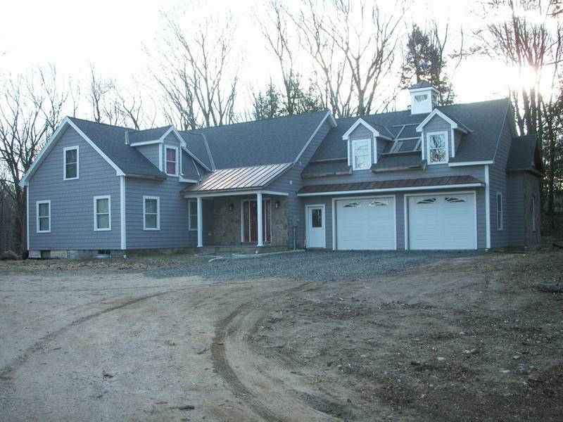

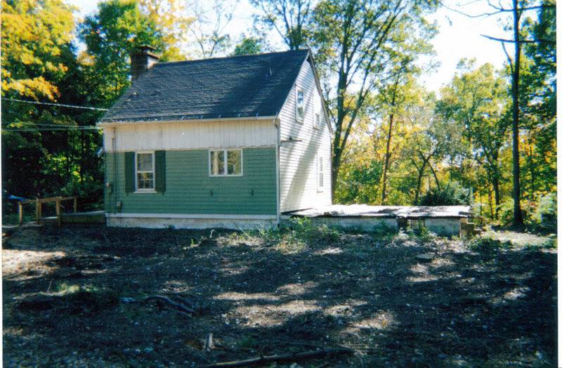

I spent 5 years (02-07) adding 2K sq.ft., over sized 2 car garage, and then once the new addition was finished a complete gutting and redo of the existing house. I forgot to mention our bonus room is over the garage. The only work I hired out was the new electrical service to the house and I had a buddy start up the a.c. units. Other than that I did all the work.
I was a framing contractor for 25 years so unlike my automotive skills this stuff was right up my alley.
I went from this .....
To this.........
The exterior is now complete other than paving the driveway.
At the time I had no idea that the Mopar bug would come back to haunt me otherwise the construction would have been slightly different in design. Now my poor truck stays outside, have the room for detached garage but for now I think the Maxjax would be a good option for me.
At the time I was very content with having ample room for my work truck, wife's car, and some storage space.
