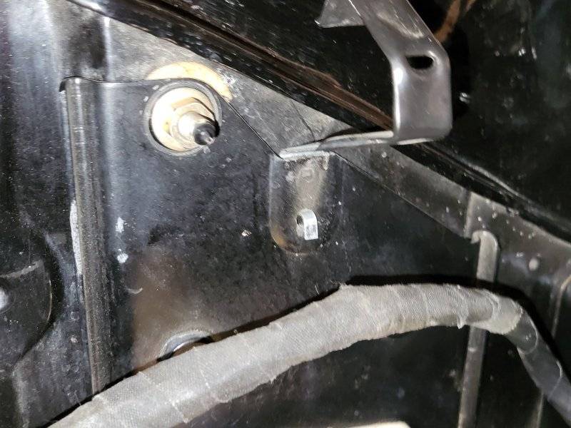

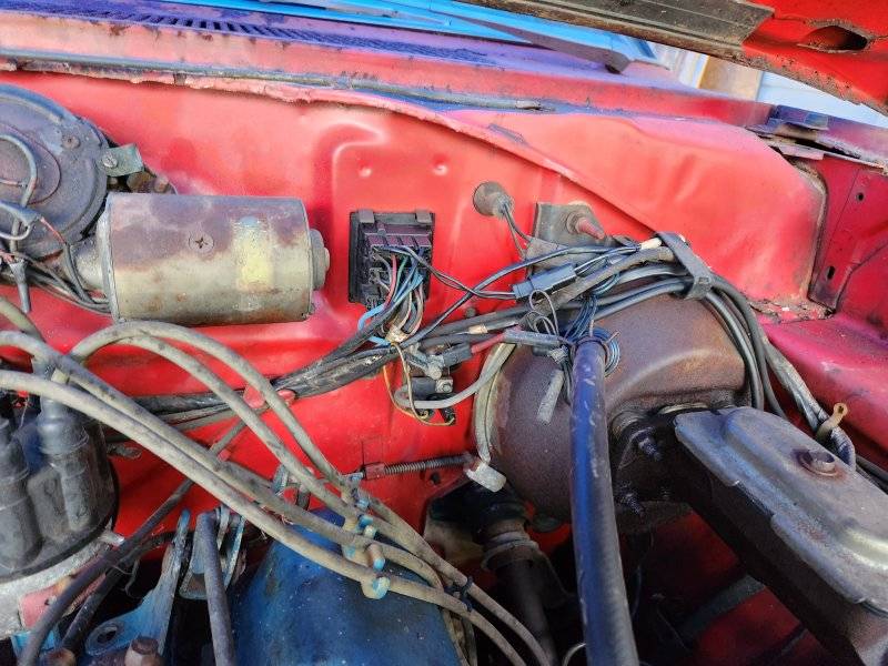

I am running a few last wires in my engine compartment, and find that I have an area over the top of the Disc Brake Booster that appears to be missing a bracket.
The bracket would appear to attach to the backing plate for the booster, and hold the wires that pass over the booster in place.
Anyone have a good pic of the bracket to help me track it down?
Mike

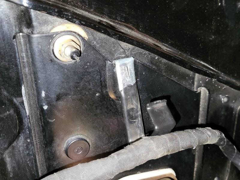

There is 2 different ones, one is for power brakes and 1 is for manual brakes.
The car has PB. It looks like the top part of the brackets have a tab that corresponds to an existing hole I have in the firewall in that area. Is the rectangular slot at the top of the bracket designed to lock onto the booster?
Mike
70 charger
The bracket clips into the reinforcement plate behind the booster / master cyl
And you have to unbolt the reinforce plate... or at least loosen it to get a 1/2" gap... to install the clip!
