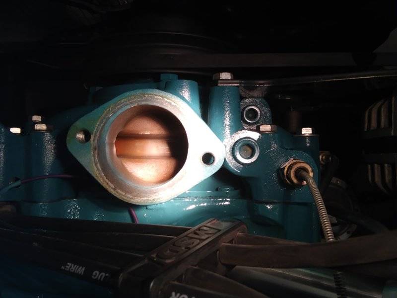

I was having some strange temperature spikes. The electric dash gauge really never fluctuated, but the Auto Meter manual gauge would jump from 180° to 230°. Then back to 180° then to near 260°. Whenever it happened there was some loud knocks. Didn't matter if I was on the highway or sitting in the shop. The fluctuating was really quick. I checked everything from a bad gauge to a head gasket problem. When I pulled the T-Stat, I just drained enough water to not make a mess. Never saw anything that jumped out at me until I took a small screwdriver to check the bypass hole in the housing. I couldn't find it. So I drained more water and low and behold, no HOLE.

I was having some strange temperature spikes. The electric dash gauge really never fluctuated, but the Auto Meter manual gauge would jump from 180° to 230°. Then back to 180° then to near 260°. Didn't matter if I was on the highway or sitting in the shop. The fluctuating was really quick. I checked everything from a bad gauge to a head gasket problem. When I pulled the T-Stat, I just drained enough water to not make a mess. Never saw anything that jumped out at me until I took a small screwdriver to check the bypass hole in the housing. I couldn't find it. So I drained more water and low and behold, no HOLE.
Check and recheck, then check again what you're buying.
Shame on you, PROFLO

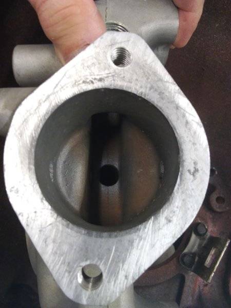

OK, please school me on this one.... What is the bypass hole?
It allows a certain amount of coolant to mix/flow before t-stat operates. It's like a "dead-head" without the bypass hole. Water pump is trying to pump but it can't move any water until the thermostat opens. When it does open it causes a thermal shock.

When I built this engine I had several aluminum pump housings laying around. I just grabbed the cleanest one. Maybe that's why it looked so good. Because PO found out it was bad and changed it. How many of y'all ever knew there was a hole there or checked it before installing? I knew housing had them, but it's not something I normally check. I will from now on. I really don't want to remove it, so lots of grease on the drill bits. And a good shop vacuum should work.
Well finally got back to the '65 after Christmas, grandkids and a funeral. Got the hole drilled. Lots and lots of grease on the bits and a good shop vacuum.
Amazing what a ½" hole does for cooling. No fluctuations, no noises and never got over 185°.
