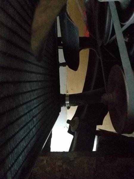

You can use a brand new lower hose for BB and clamp it on the smaller SB rad and it will work. I did it like this for 2 years and it worked fine.

same for me used continental 60659 hose

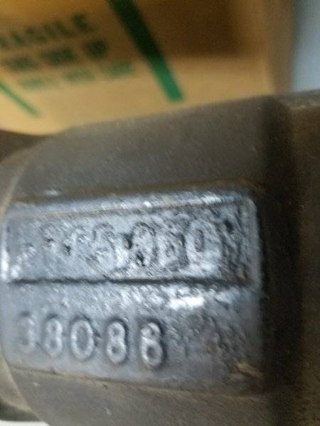

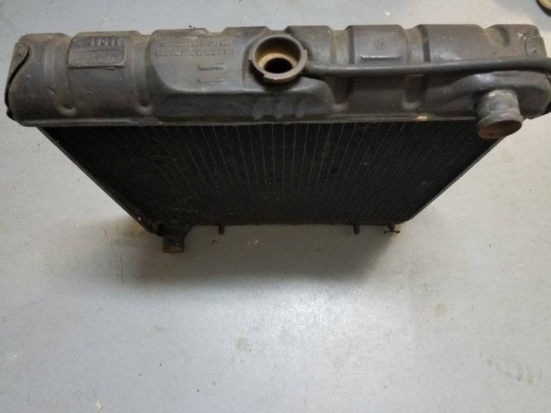

Here is the 22" in my 318 Belv. p/n 2785 965. Upper connection is just to the driver's of center. Bottom on driver's side.
Here is a 22" out of a 67 383 2-bbl Satellite, p/n 2785 960 - hard to see on the part, but can definitely make out the 60. Upper connection on pass. side, lower on driver's side.
