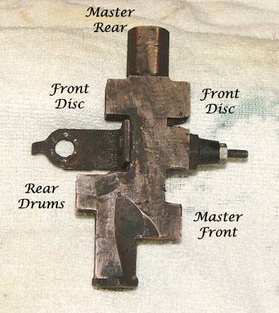

Can anyone tell me which line goes to the front brakes ? front port closet to rad/ or rear port near firewall. Thanks
Rear port closest to the firewall.
Sometimes it's hard to tell but in general the front brake reservoir is larger.
