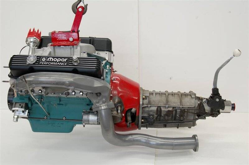

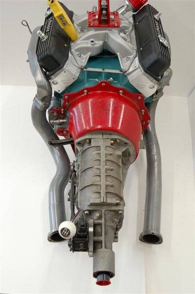

TTI makes them to fit the manifolds. They need the casting numbers so the flanges will be oriented in the right directions. I did this to my 64 Plymouth, and the fit was perfect.
Another vote for TTI. Perfect fit for my 65 Bell with HP manifolds.
