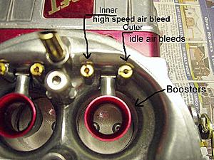

which holley 850 do you have? if you dont have adjustable kill bleeds, that may be an issue.

I have the 4150 series. I never heard of adjustable kill bleeds so most likely don't have them.

Mentor70 probably intended to say adjustabe air bleeds, by removing them and changing them out with different ones.
here is a picView attachment 286707
