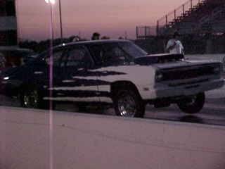

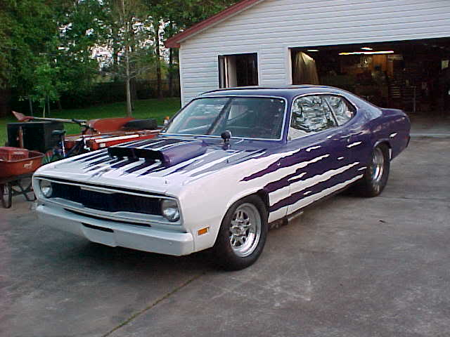

Ran high 9's with a set on a 470 stroker in a 2950 lb Duster...some here may know this car....the heads were ported of course....
