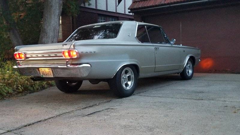

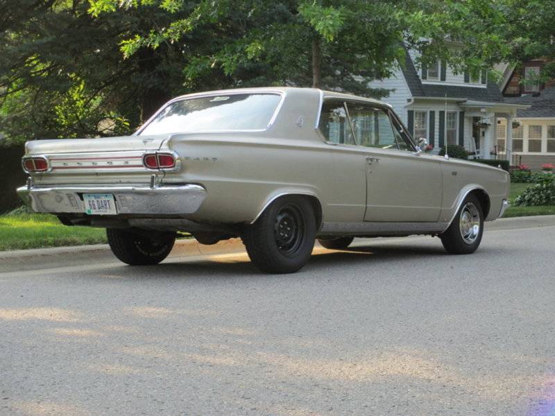

You talking on early A's? I have used 15x7's with a 4" backspace and 225 70's on the black wheels and 235 70's on the Halibrand clones.
Yes.4'' should. Like all Mopars of this area you may find that it fits on one side and the inner fender on the other side may be closer and need some massaging.
