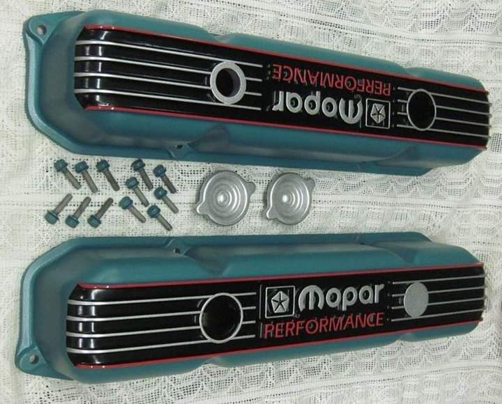

I painted my engine and valve covers with Mopar brand turquoise paint which seems to be no longer sold/made. I am going to replace the valve covers with something that hopefully won't leak and was wondering if anyone has found a powder coat brand/colour that matches the Mopar rattle can.

The suggested turquoise up there is actually a Pontiac color. I can hook you up with the right one.
Thanks for the mention @Lefty71!!!
