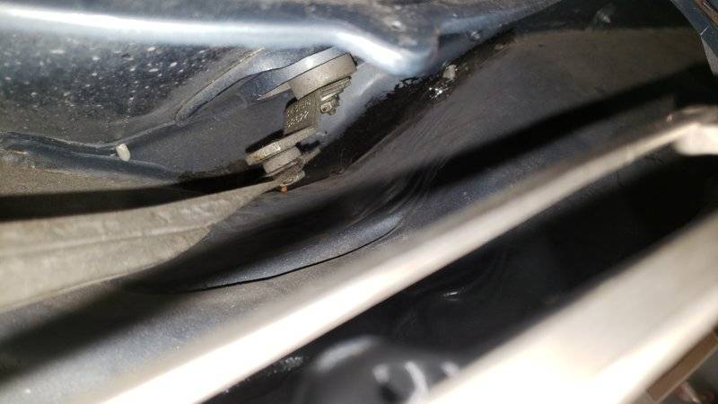

I bench tested and everything worked fine....but there was no way to tell if it would line up with the linkage. Does anyone have a pic of the cowl side? I knew I should have taken one.

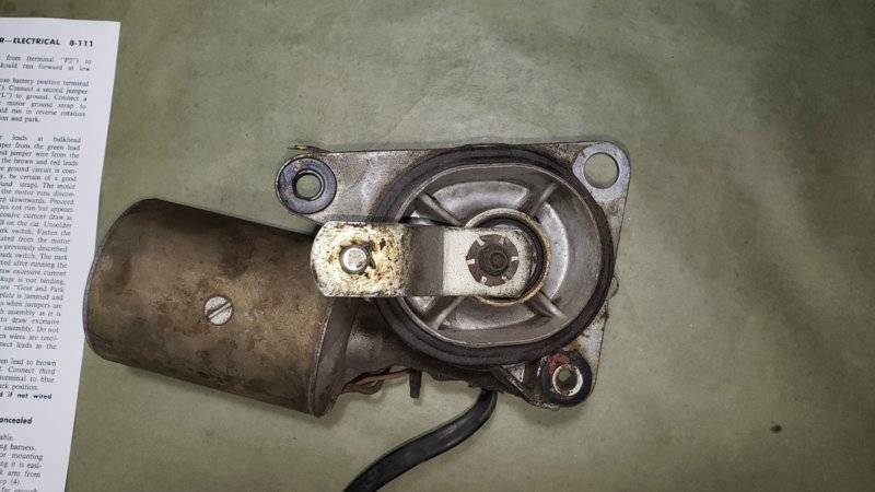

Does anyone have a picture of the other side of the motor? I want to see which way the arm that attaches to the shaft is pointing in the park position.

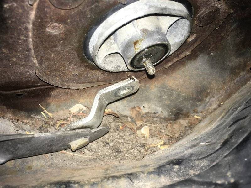

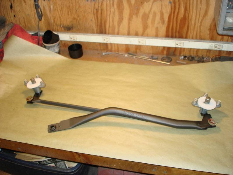

Be sure you have the links connected to the correct studs on the driver's side pivot otherwise it will bind up and make noises. Motor link goes on top, cross link goes under the drivers's pivot crank.
This one is an E-body brass bushing style but the link orientation is the same as B-body;

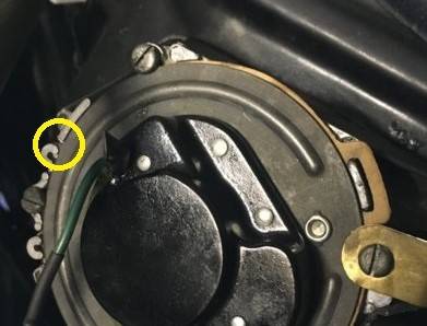

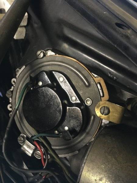

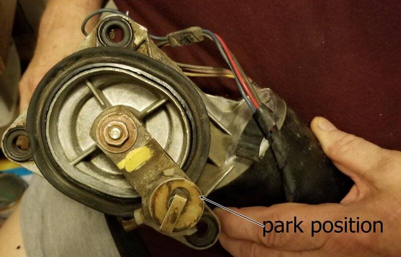

Hello..... I just finished taking my 67 coronet wiper apart for general maintenance and want to know if I am a tooth off one way or the other does it make a difference in its operation?
A picture of before and now is.
Thanks in advance....

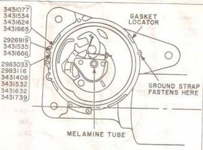

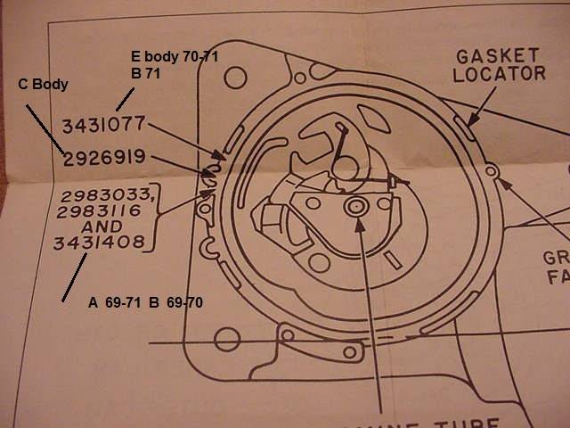

The motor park position on a three-speed motor has nothing to do with the drive gear teeth. Only the clocking of the park switch plate/cover as pictured above. Check the FSM for the correct notch indexing for your application.
Sorry but what is FSM please?
The photo of the motor that I posted is the way it came from the factory before it was dissembled.
I replaced the cracked gear and re greased the worm gear and plastic gear.
Can the park position be a tooth off one way or another or will it bind up?
I found no markings that would indicate some sort of a alignment.
When I say tooth I mean in park position I may be off one way or the other way from exact park.
There are no dots to align up......... like on a cam gear and crank shaft gear.
