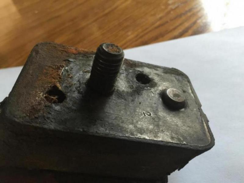

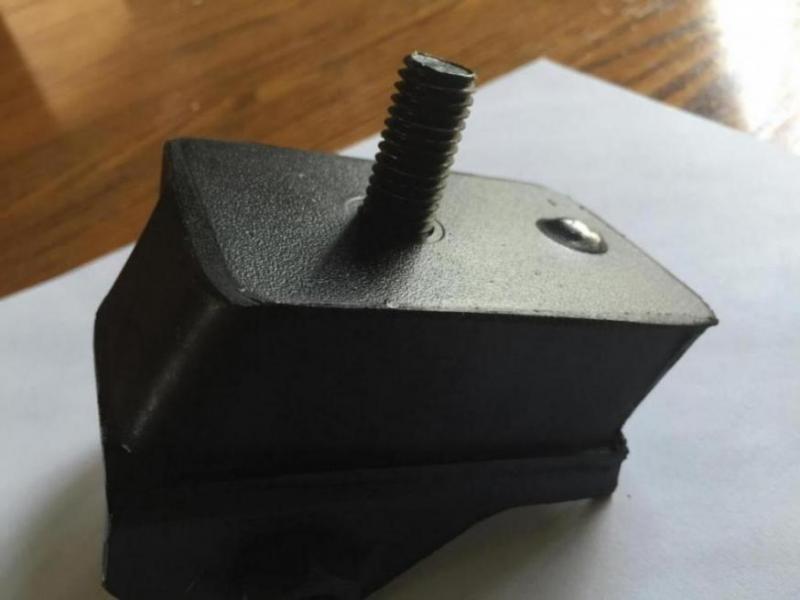

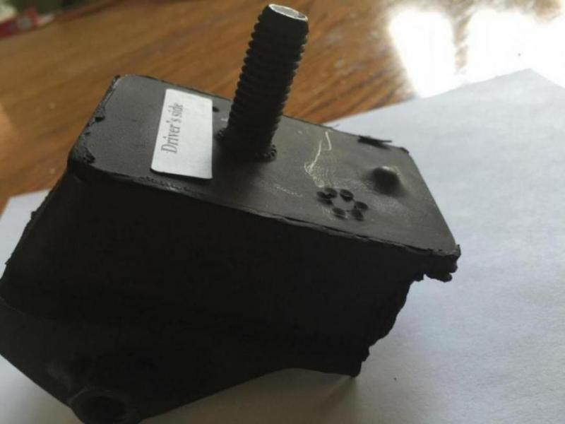

1st pic $60
2nd pic $ 135
3rd came with the car
What keeps the mount from slipping if all there is, is a tiny little button. Seems like to me the 3rd pic would work the best. Any thoughts other than Schumachers

The second pic is Dynatech. I thought if the locating dowel went through the hole a little bit more like the 3rd pic then it would prevent the mount from slipping out of position.

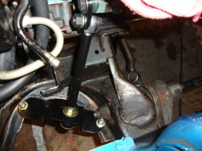

Mancini sells a set that is stock rubber, but with a bolt through on the drivers side. I used these along with a torque strap on both my cars and am happy with them. The rubber transfers less vibration than the Poly Locs.
hunt2elk... exactly why I didn't want the poly locs
stock rubber for vibration dampening and a torque strap to keep it all in place...

That's what I used to think too, until I had one fail. Passenger side on a 335hp motor. Talked to Mike Schumacher about it. He was very good about it even though they were 3 years old. He gave me the choice of a new poly loc, or a set of standard rubber mounts as a warranty replacement. I took the rubber mounts after he told me that they were having some issues with the biscuit style poly locs failing. He was in the process of designing a spool style that will take the place of the biscuit style on our B-bodies. He said the new ones will not come apart. This was last year and I don't think he has the new ones out yet.
My dads 505 and my 5.7 Hemi had/use them without issue. I also don't see how a pass. side mount could fail when it just gets compressed as opposed to the drivers side where it can get pulled apart. But, stranger things have happened.
I used the torque strap as well for added insurance with new stock motor mounts.
Yeah, I couldn't believe it either. That is why I called Mike. He wanted to see pictures of it and then confirmed it had failed. That is when he told me that I wasn't the first that it had happened to and why he was redesigning the mounts.
