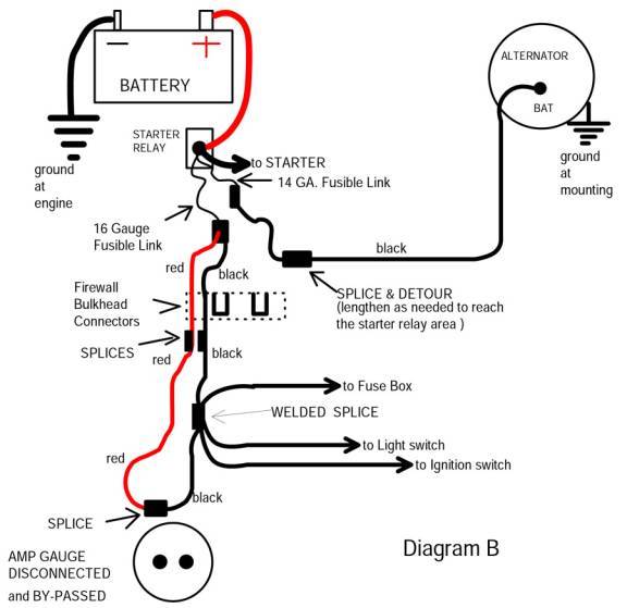

Ok guys so I don't see a fuse link in the engine compartment. Only a replay but seems to be distributing power.
Looks like a pair of fusible links right after the relay. this pic is a 87 Ram charger but should be pretty close to your D150
That is a general picture of the MAD wiring modification.
There should be a fusible link going into the firewall bulkhead connector. Also, check yourfuse box for any blown fuses.
