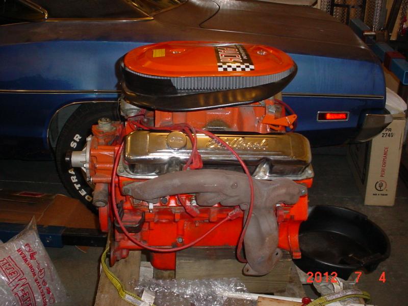

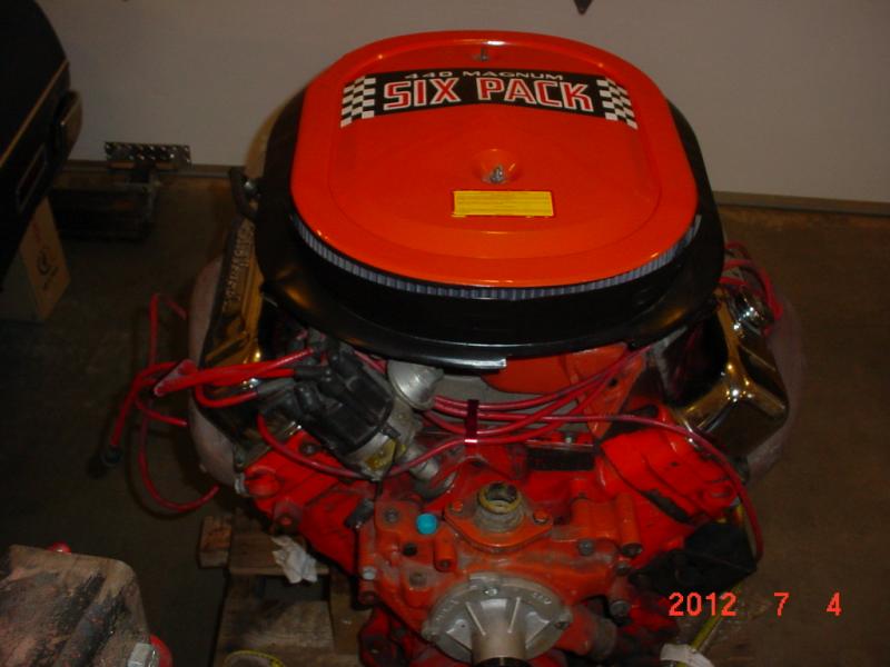

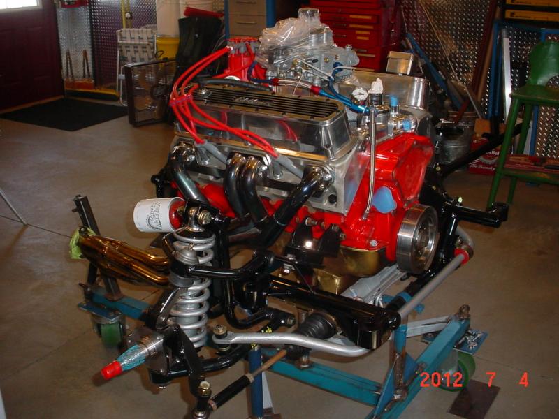

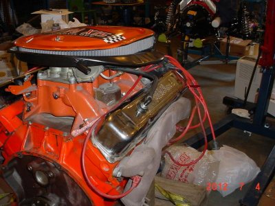

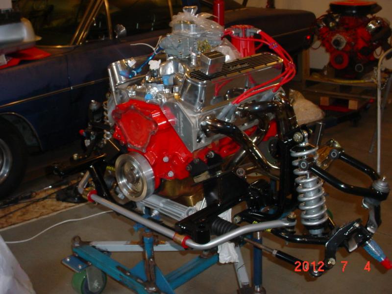

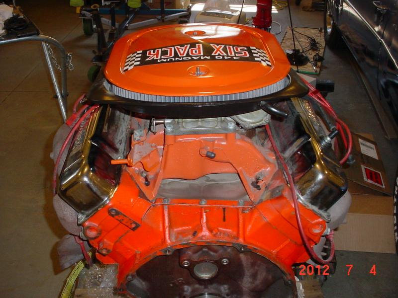

Just wanted to pass along some pictures of my motors for you all.
1971 440 MAGNUM SIX PACK
340 REST BLOCK 4 BOLT MAIN MOTOR STROKED TO 410 cu. in.

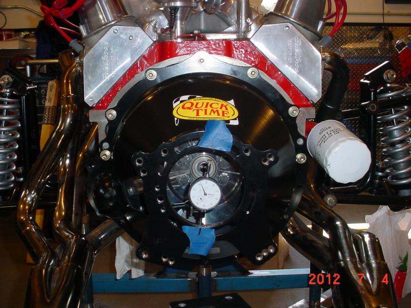

I'm waiting on a set of 7 thousanths offset dowells for my bellhousing on the 340. It's pretty important to check your misalignment on yor bellhousing to flywheel unless you want to deal with the vibration and cost of a new clutch. The 340 will be going in my 68 Cuda fastback and that sixpack will find its way into my 70 Bee sometime this winter hopefully.
They look great! Bet that 340 sounds good..
It made just over 475 hp and 498 ft. lbs. tq. on the dyno with out a whole lot of effort. I have a 3" X-Pipe exhaust system with Badlanz electric cut outs just incase I feel that I'm not making enough noise? The six pack will be hitting the dyno this fall after I tweak on it a bit.
