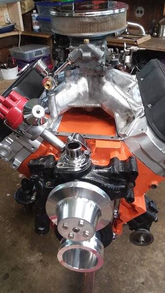

Get it. Nothing wrong with the MH 440's. It will likely have heavy rods, a sewer drain type water pump housing ( that's a good thing), a double row timing chain & a forged crank. Swap out the rods for LY lighter weight ones, slap on a set of nice heads, have the basic machine work done to it, maybe punched out to .030 or .040 over, a dual plane intake and a 750-800 CFM carb, slip a Comp cam in there w/ lifters and burn rubber everywhere u go...
This was originally a MH 440...
Very nice btw
