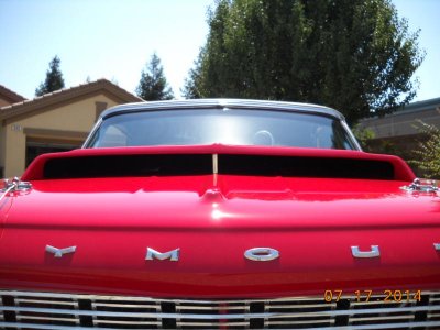

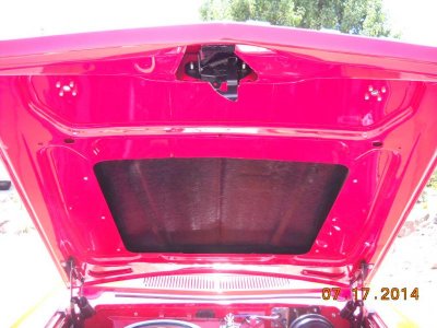

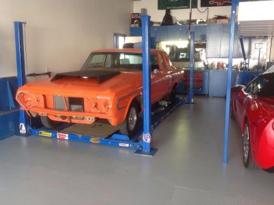

Not a VFN scoop, but epoxied in aluminum plates on top of the inward turned lip and threaded them for attachment screws. Added the stainless steel pin in the front for extra insurance.

What brand scoop Dave? I am looking to get one for my '65 vert

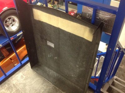

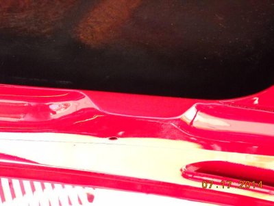

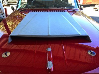

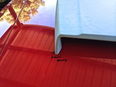

The scoop is a Glasstek. Even though the scoop is heavy weight glass and well made I would not recommend purchasing from them. On close inspection, looking at the opening of the scoop from the front, I saw that one side was 90* to the hood and the other side was 'splayed' out about 3/4". I contacted Robert about this and he stated that they had taken the mold right from an original factory aluminum scoop on a hemi car. He said that he knew the car owner and that it was made that way by the factory tin bender. I asked him why he didn't tell me this before I ordered the scoop. His answer was that he hadn't gotten very many complaints so he continued to ship them that way. He did give me the option to return it. I elected to split the upright side lengthwise and re-glass it to make the sides symmetrical. It was a lot of extra, unnecessary work. I don't care about originality on my car, as it's a 63 Fury with a non-original max wedge and a hemi scoop...
I'll add a couple of pictures so you can see what I'm talking about.
Robert's a nice guy, but wasn't forthright with me and therefore, I won't recommend him.

Thanks for the advise and I will be doing exctly that. Right now the back of the scoop is sitting up at the rear centre so I need to get it flush across the back and then follow the hood contour for marking. Need to set the Indy set up on the engnie first too in order to see what I need for room for 3" X 9" oval filters. Do you have an idea what amount of slope would look best for the scoop? I'm running a newer K frame so the engine is back almost a couple of inches too.

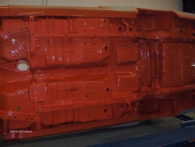

That is noticeable for sure. Definitely needed to be corrected. Nice 63 and the underside of the hood, very professional!

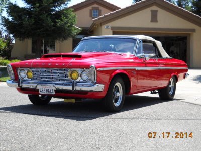

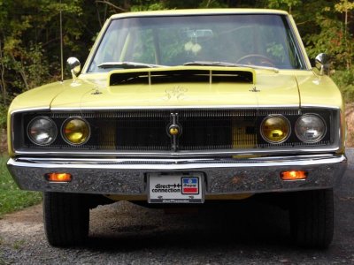

my scoop on my coronet is from vfn. and I just put 2 bolts down through the front and bolted the l brackets down and has worked fine. been on my car since 2005. i'v had the car up to around 140 mph on interstate a few time's to blow the carbon out and nothing has happen. here's a pic. of mine.1116206_10201144602873396_1456893612_o.jpg
my scoop on my coronet is from vfn. and I just put 2 bolts down through the front and bolted the l brackets down and has worked fine. been on my car since 2005. i'v had the car up to around 140 mph on interstate a few time's to blow the carbon out and nothing has happen. here's a pic. of mine.View attachment 202358
That tells me the front bolts are adding lots of reinforcement to yours. A good move to use them and 9 years with no problems speaks loud.

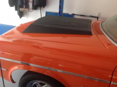

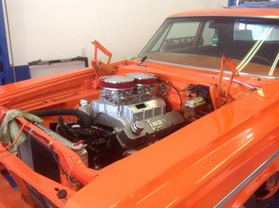

That would have been a good deal for sure Super! I do have access to another very mint stock hood still. I got at it today and making good progress. I'm glad that I went with the 5" and then worked my way down. The height is good now, I have 1" of space between the air cleaner and the scoop. The Victor Max Wedge Heads will rise the intake about a 1/2" so I need that space. Next I'll make my aluminum angle. That will take awhile by the time I drill it all and increase the angle to match the scoop and then glass it all in place. Once all the scoop fabrication is all done the old girl can come all apart as it get's a complete face lift on the rotisserie!image.jpg fibimage.jpgimage.jpg
