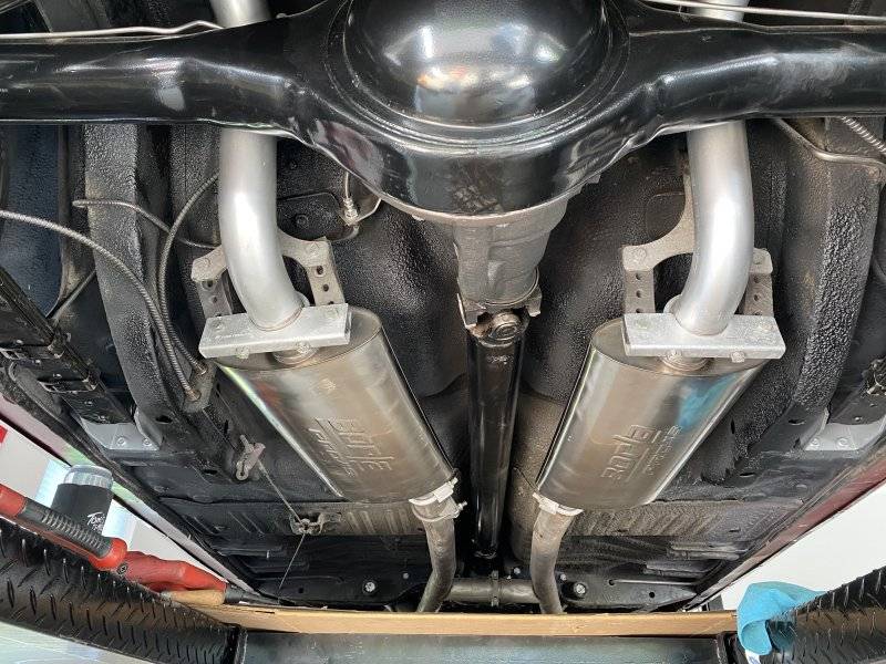

I was looking to replace the dynamax mufflers on the 67 RT. Wasn’t in love with the sound and the drone was unbearable. So I used the search function and several members suggested the Borla Pro XS. So I ordered a pair with the 19 case and 23 overall length. I put them in yesterday and I love them. No drone at all! I can listen to the radio or have a conversation. Very nice bark if you put your foot down on the go pedal and they are stainless steel. As a bonus they were affordable at about 110 dollars each. The forum members here really are the most helpful group out there.

Those hangars are pulling at an angle, they will fail early, they need to pul straight up and down.

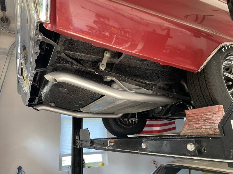

Not to be a picky critic but I think the tailpipes should maybe be a little further back?
If the hangars on the back of the muffler were straight vertical I'm thinking the outlet would be even with the bumper.
You may get some fumes even with the turndown but then again perhaps not...
Maybe you wanted them where they are?
Hi Don, I was limited as I was trying not to touch the existing H pipe. The mufflers that came out only had a 14 case, I ordered the 19 case as I had a large void to fill. Because of the way the H pipe was bent the driver side muffler was not in the best location which was causing problems getting clearance around the gas tank and maintaining even a minimal clearance for the shock absorber. More to your point the over the axle section of the tailpipes were centered over the axle housing so that kind of predetermined where the tail pipes terminate. Did the best with what I had to work with :)
