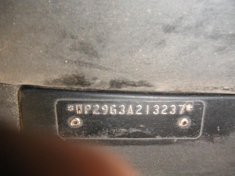

I believe the car came to Aust via a US Military person stationed at Pine Creek in Darwin,when that was I have no idea.
When I purchased the car this is how it lookedView attachment 131625

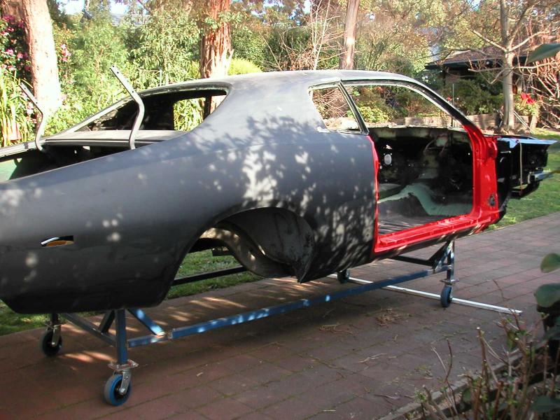

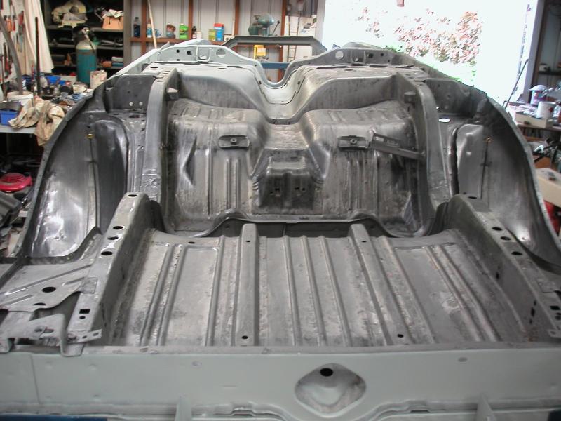

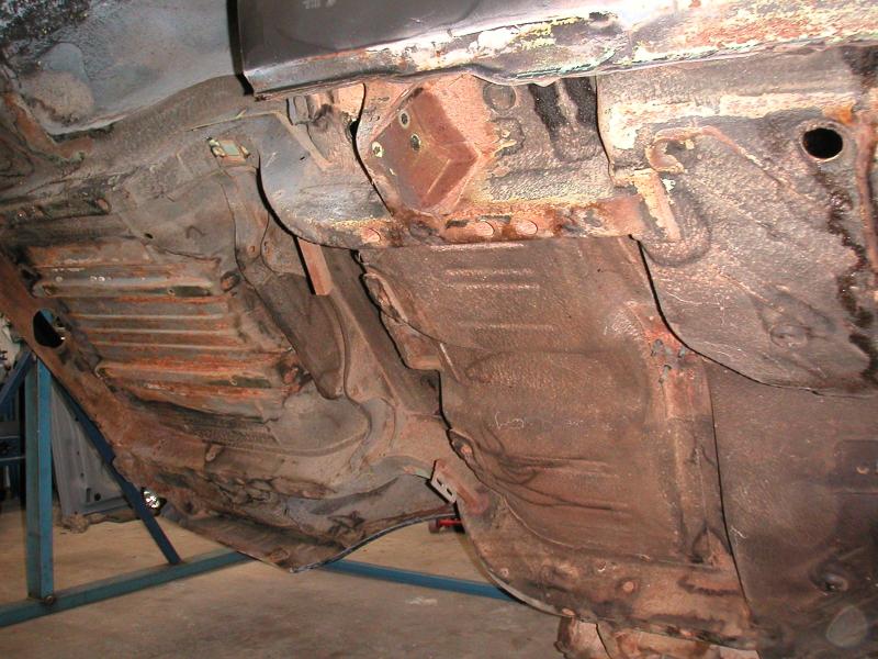

I made decision to have the car chemically stripped of all paint, body deadener and rust,as you will
you will see the results,this I would strongly recommend to any one doing a full resto.
As you can see ,you would swear it just came of the assembly line

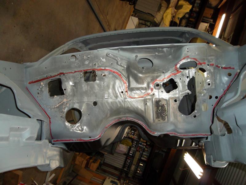

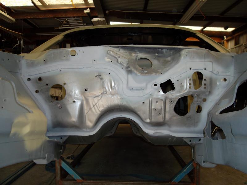

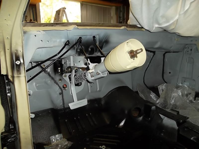

Now the problems begin,this car was converted to RH drive:angry1: how do you fix the problem,easily,cut out the firewall and have a bulk head sent from the states with a
K member ( approx 6" was cut of the tail end of the frame), steering box,dashboard,steering column and other associated parts

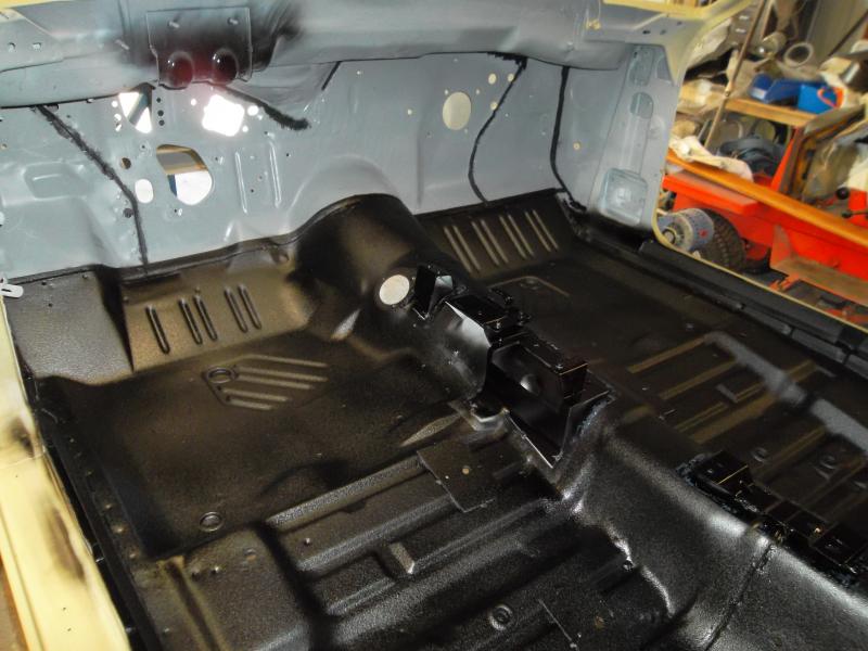

All primed,sealed and body deadener applied

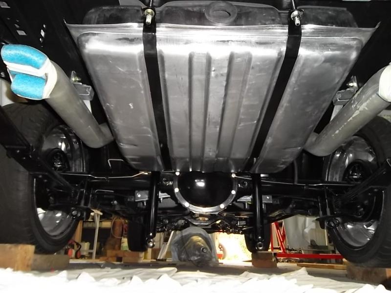

Running gear on with a TTI 3" system

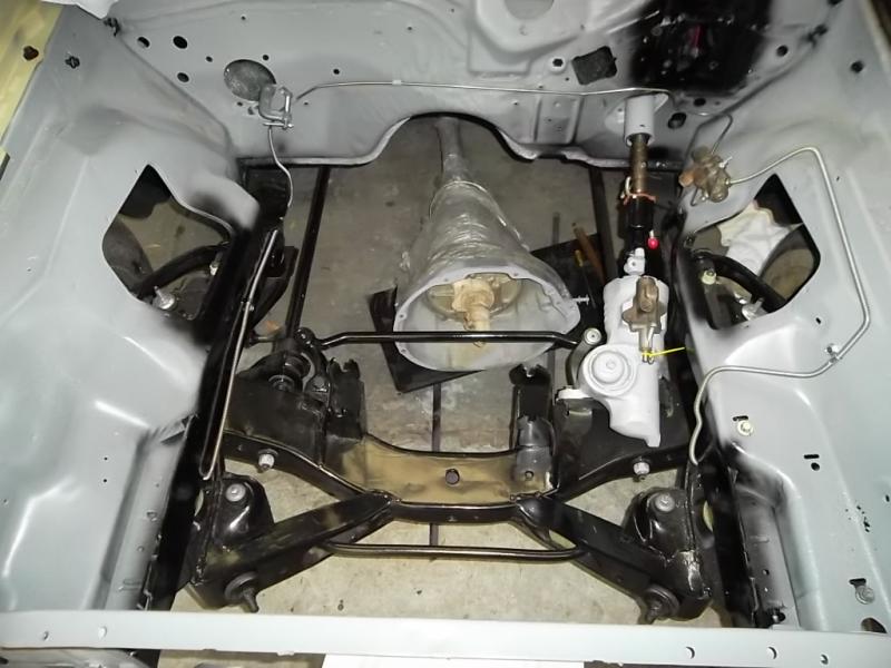

Last two pics are of a pre-fit,one thing I did learn is that when you assemble the 383 and 727 tranny with a deep sump they wont fit ,tranny in first then couple up the 383.
