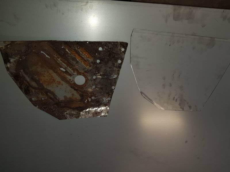

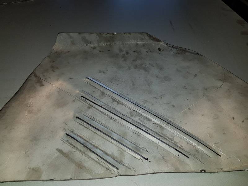

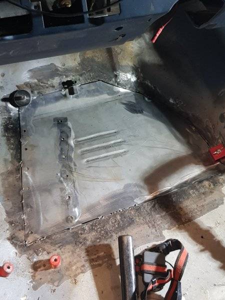

So ive had a crack at cutting out and making my own floor pan for my 69 dodge coronet.
It's turned out alright and since then i have made another that has turned out mint. I have used my bead roller for the first time making some beads to strenthen it.
I would like to start using an english wheel of anyone has any recommendations on an entry level one.
The photo is of my first attempt. Dont have a pic of the second one. I
Found the first one curled up a lot from making beads. The second one i pre stretched the lines i was going to bead. Turned out way way better.

what'd you stretch it with?
I used a technique i learned off YouTube.
Turned the peice over and reverse rolled it in the bead roller.
So just marked out on both sides where the bead was going. On the reverse side i only slightly rolled it so it had a small indentation and then flipped it to the top side and carried on as usual. Works great

That's the only part of the pan I have to replace. Very lucky. Looks as if someone's had an attempt to put the boot pan in but it's been welded very poorly so I will give that some attention to.
