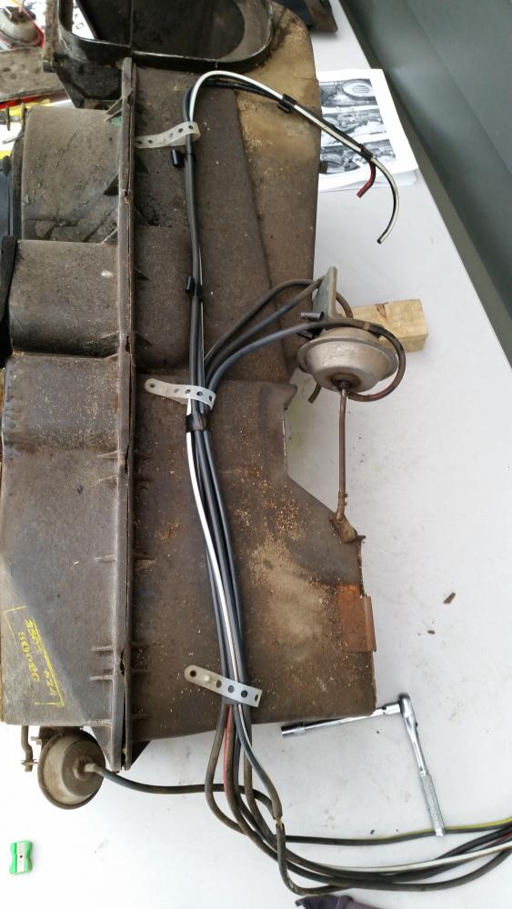

Step 1: Disconnect tubing
Step 2: Disassemble all of the plastic parts

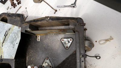

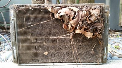

The inside of your box will undoubtedly look similar to this.

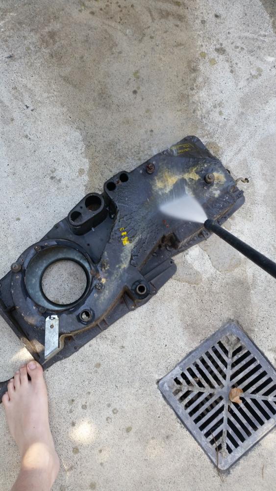

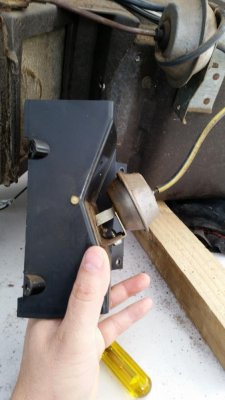

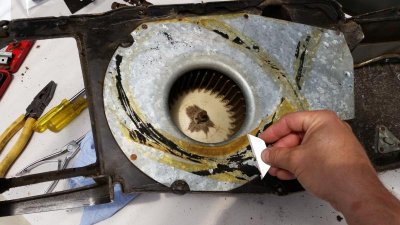

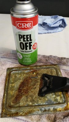

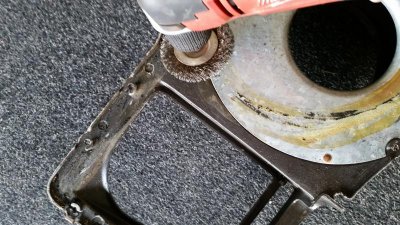

Step 5: Strip all remaining items like actuators and brackets from the housing. Then thoroughly clean it. I used a couple of methods. First I pressure washed it (not heavy) and then to remove the stubborn gasket material, a blade and a light wire wheel.
Step 6: Remove all the sticky residue. Use denatured alcohol to make sure you get good adhesion for your foam.
Step 7: Treat and paint all rusty brackets, actuators, screws etc.

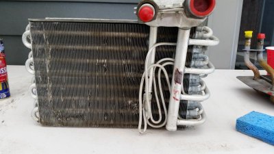

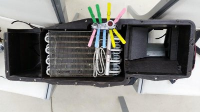

Step 8: Visually inspect and pressure test ac evaporator and heater core. Flush R12 freon out of evaporator so it can be replaced with R134a. You must never mix different refrigerants.

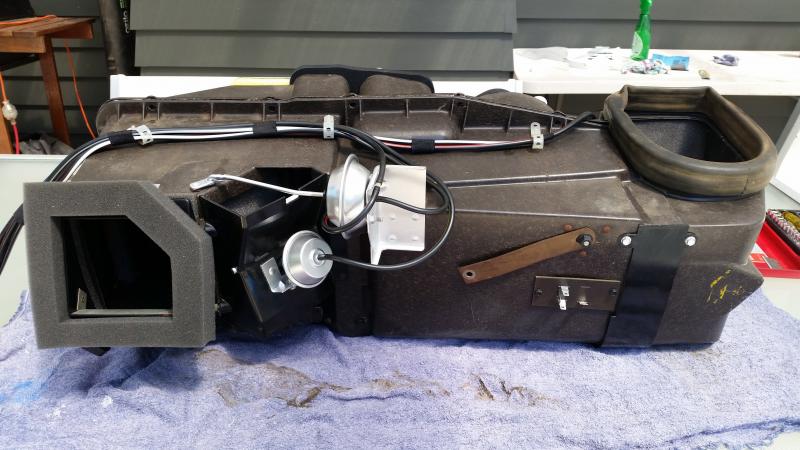

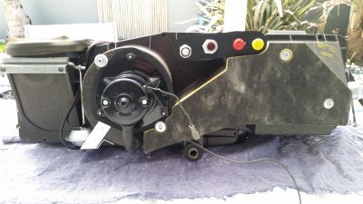

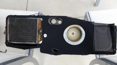

Step 9: Continue to install the rest of the foam and reassemble the box.

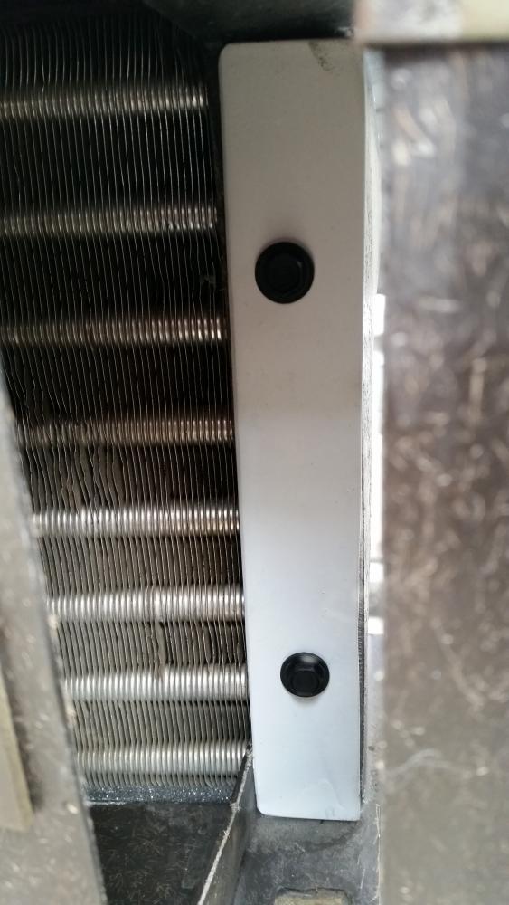

Step 10: Re-install the heater core and evaporator. In my case, the box was quite weak and broken around the screw holes for the evaporator. The evaporator has a bit of weight in it and the jarring from driving would have caused this to happen.
I made a steel plate to install as a washer to mitigate the problem.

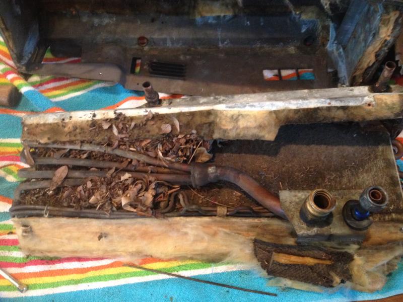

Oh, that brings back memories of doing mine!!!! Nice job on that one!!! I found an old bowling scoring pencil in my heater box along with some leaves!!! hahahahaha

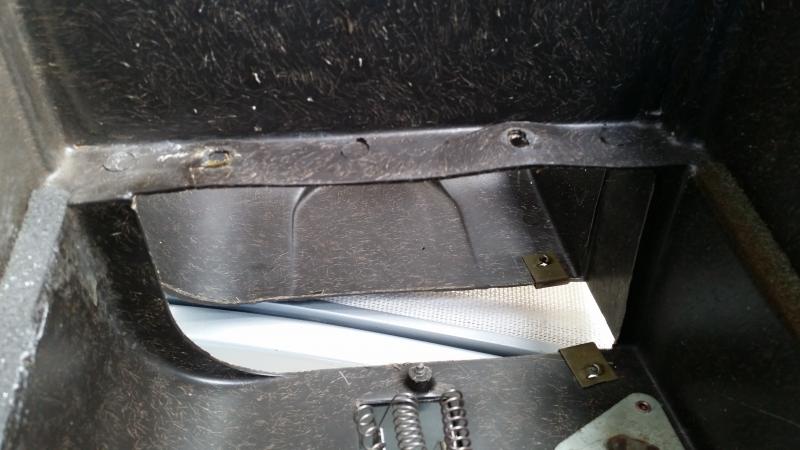

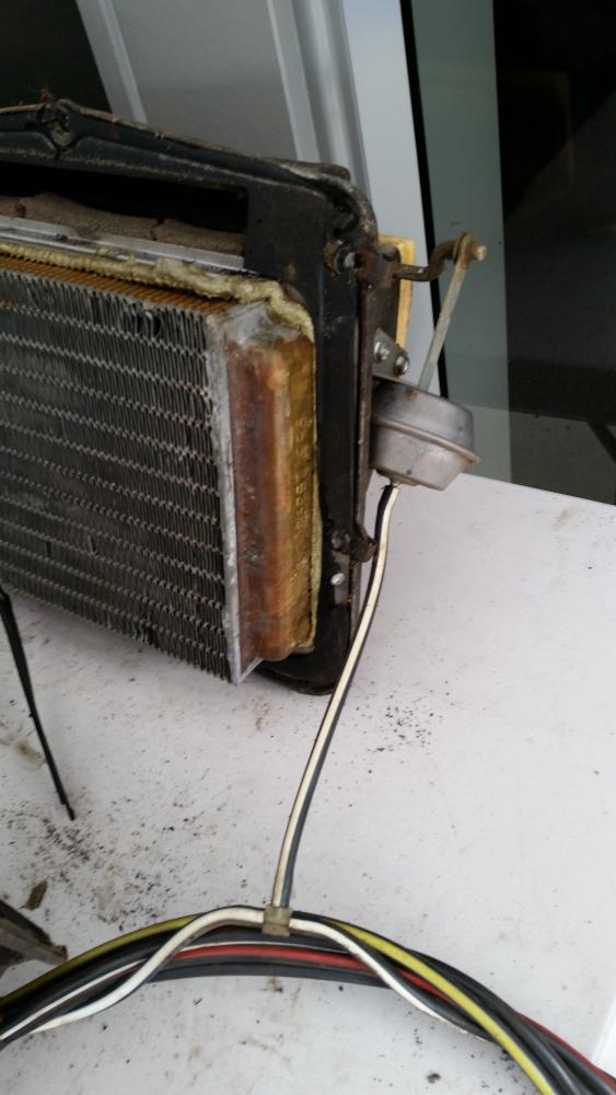

Anyone have any pictures of where all the clips go that hold the halves together?
I have 9 clips, and have the 'j' nuts on the two ends (4 total) but wondering if there should be a few more screws to retain the halves or if it's all held with just clips.
Thanks.
EDIT:
I kind of answered my own question. I found this post http://www.forbbodiesonly.com/mopar...uestions&p=910197868&viewfull=1#post910197868 and it shows a few more screws being used....so now the search begins for the missing clips and screws.

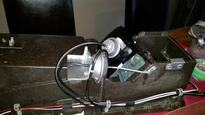

I just took apart a unit out of an old 71 I had and was supersized to find the two halves held together entirely with the J-nuts and screws, none of those spring clips like on my other 72 unit.
I also found these little tips on the back-side of some of the screws....never saw them before.
B6MhlXl75qgHXUt4RJgmLec2YDOm8SXdCuuquV7DyqHcUjWaI8_OkbB-uBEVvMjQep1RLo8X_FCqW9EihPpXLR26fBnL_TiyEYvnV9pgua3JxcK0C0iCmboImYVfdbkm3uqJby-n2ZM2nBcQehlC8d5SZqj6IPbF42sQMHDcW4ZwUKlxZSmXb8sMjyVZ7OsiLiW23cGNnA-7mo9Xvm_mKKJk2WV6UhOUm_swoHVj7wppTdzKbC4x6kp4fhrvtJDZcd-MDwMuJIdrejwRD75GfL7OV93e2kXPFM-T2f7N8cW3L5rbQSeSvdId8s5txEICTpqgg8tJLLHx6MhKTNu3l4VrCiXFeO4jqFJUTSH2YanTuCEmWqZuYYHZQyJwUKO3aLEA372ICrzY2D_qox7N0_PFweRAERhFACfQs208vboMGOKKMoFWTTadUR9jA4GjjnqPYD8WHJ2u3tF7j_l-wlz7LhzyYMPTLowbz0hm6GVhjRQeAUlVSCBIcuzmN8NyT-W4WNY7D1zKD2JuWPA9U1B2dbtSt8e1Zx_xyX7rNxaEFml1gmW3E16sH1eENP2f7xXX9CtXaaLHP4KKiPARdK_QP4Wccys=w1211-h681-no
Bonus, I was able to take the actuators as a few of my other ones were bad.
