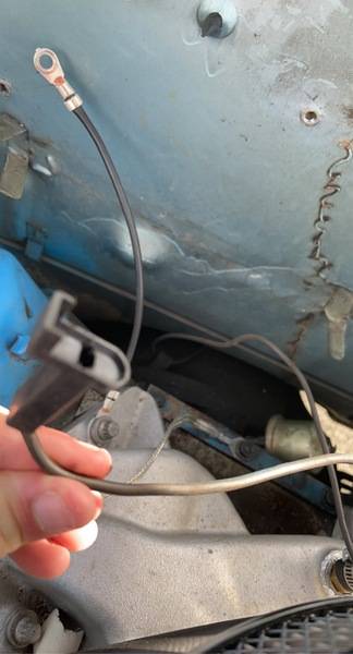

Couple things. Does anyone know what the wire from the first pic is? I can't find it in my schematic. It runs over the top of the transmission. Second, how would I go about cleaning the bulkhead disconnect? Is it fairly simple to replace this if I have to?
The wire connects the neutral safety switch on the transmission with the starter relay. It should not run over the transmission. It exits the neutral safety switch on the left side and continues on the left side of the motor and trans (at the inner fender side) to the relay. For a temporary solution you could spray the bulkhead connectors with a spray used to clean electrical connections. However, replacing the wires in the bulkhead connectors is inevitable; they are just too old. To take it off you push hard on the four metal corners you see in last photo and the b. connector will go through the hole it sits in and you then take it out from the inside. I will also suggest that you should bypass the ammeter when you replace the electrical wires because, if it is original, it will eventually cause a short out and possible a fire (don´t ask me how I know).
