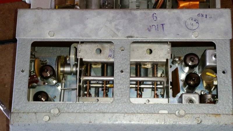

I have this AM radio made by Automatic Mfg model pp-2658, 265B, or something like that, but I am not sure what car it came from. I know some 40's and 50's era Plymouths came with radios from Automatic Mfg, but I think this one might be from the late 50's. Anyone know more?
Automatic radio made mostly Delco lookalike units. See if Howard W Sams has a schematic reference. That may tell you what car the radio fits.
Looks like it has a vibrator, so 1950s is correct. The vibrator capacitors dry out, the contacts arc, and the radio dies.
Real radios glow in the dark :thumbsup:
PP-265 Automatic 1955 Plymouth AM PB radio
Howard W Sams and Riders show no schematic information
Looks like it's a simple 'all American five' AM Radio. Five tubes (one is missing on yours). Probably a 35W4 rectifier, 50C5 audio amplifier, and 3x 12xx6 tubes.
Interesting, not sure how you come up with 5 unless you are not counting the missing one, it should have 6, 4 internal 2 external. The big capacitor on the back, it rattles, so I am guessing the internals are dried out. The tube that is missing is broken, and I couldn't read any numbers on it.
The tube on the rear is a 6x4, and the broken one looks similar, but could be something different. The 4 on the inside are 6ba6 three of them, and one 6ca6. all the tubes have the Automatic Mfg Stamp on them, which surprised me, I thought they would be RCA or Tung-SOL
I stand corrected. It's obviously a 6 tube once I saw the pictures on my PC.
6X4 is probably the rectifier. I've got a tube manual somewhere I can look it up.
My guess..
The vibrator is the large cylindrical can with the clips. The vibrator chops the +6 volt DC power (to simulate AC power) and runs ir thru the trsnsformer to step it up to approximately 150 volt AC (APPROXIMATELY) which is rectified by the 6X4 tube to DC to operate the rest of the radio circuits. I'm guessing the rest of the tubes are: 6BE6 converter, s 6BA6 amplifier followed by a 6AV6 audio amplifier and detector and a 6AQ5 audio output . Later there were 12 volt tubes developed to operate on 12 volts without having to raise the operting voltage to 150 VDC. The older 6 volt radios used a vibrator and a cold cathode rectifier tube, an 0Z4G and other 6 volt tubes. In another lifetime, I used to fix TUBE TYPE RADIO AND TV SETS, and had all the testers and equipment. AM radios are easy to fix.
