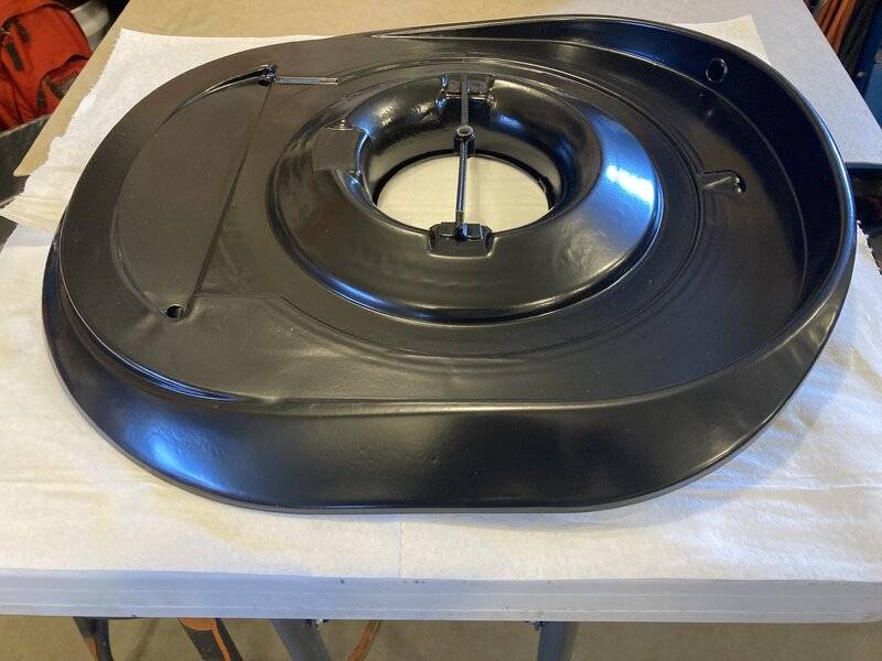

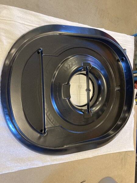

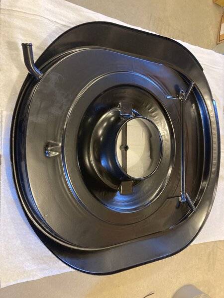

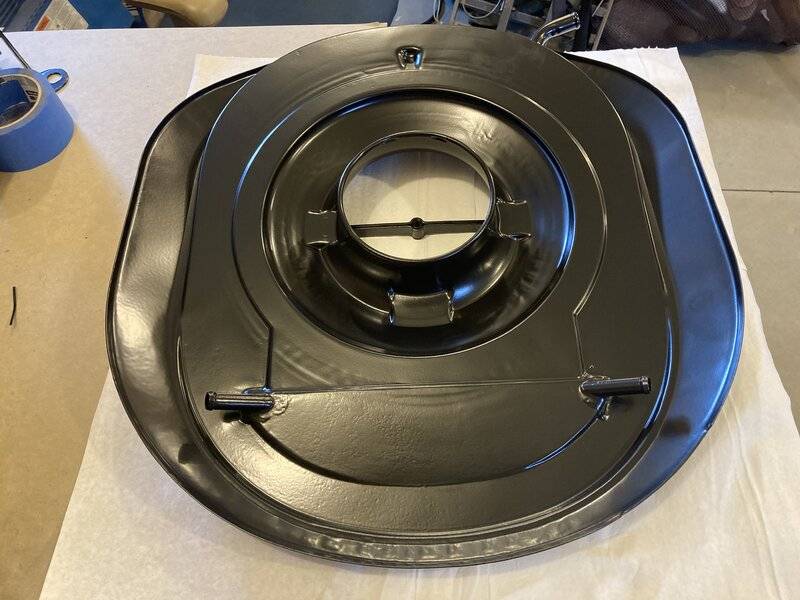

Can anybody help me identify this base plate. I had it media blasted and powder coated and would like to list it here on FBBO as soon as identified.

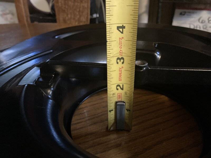

Looks like 2” to the bottom side of mounting crossbar and 2 3/4” to the top side of crossbar as I measure off of the table
CE70A16E-873D-41F4-A4E8-A137AB1048D5.jpeg 046A255A-32E1-4D05-8594-C4BE835E8D87.jpeg BB0EFDE1-7966-416D-97B8-467E9C51861F.jpeg 11F208FB-4F0B-4726-9741-44CAF0ECE2C0.jpeg 60EC2E7A-E66E-420F-ACBD-426C514CF82C.jpeg 2C84AE55-D585-4CE1-A1CC-FC0B09C71066.jpeg FC94D157-37F7-4B86-A248-43B7919B4FA6.jpeg C12FAC4C-602F-48D3-B3E0-9DB9AC7DD6D2.jpeg View attachment 1184020 04F0058E-D989-4ED9-A770-EFFC59DE11C5.jpeg FB4409C7-DB52-4D62-B9A5-E4EC6CF220FB.jpeg
2” to the bottom of mounting crossbar and 2 3/4” to the top side.

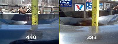

This style with the small round lid is similar but measures differently at the crossbar. Reader Mike Brodin provided the following measurements.
Height from bottom of air cleaner throat to top of crossbar
383/400 - 2 1/2"
340/440 - 2" QuickBpBp from Moparts provided the following images. If you set the air cleaner base on a flat surface, such as a table, the carburetor throat for the 383 and 400 will sit completely on the table. On the 340 and 440, the outer edge of the air cleaner will hit the table and the carburetor throat will not. You should be able to slip your fingers underneath it.
