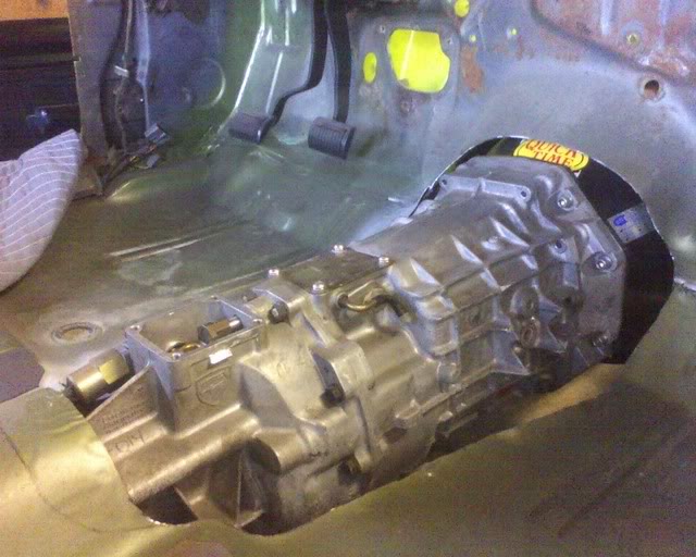

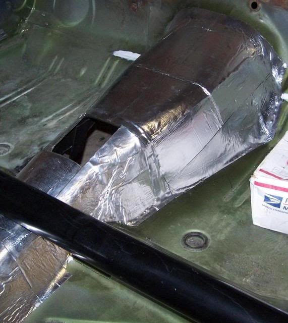

gonna have to cut the floor big time. a few have sent me pics of there b-bodys cut up. my body guy insists no big deal. he is kinda good, real good. i have seen a few of the cars he did, they came out awesome.
I didn't do this one personally, but I don't think it's as bad as people think. I mean it's not a 10 minute job, but cut a big hole, then make some patterns, piece it in, no biggy...

Well actually 2. its a 6 speed. But if you want a modern tranny with OD that will hold up to serious abuse this is about the only way unless you invest in a really spendy kit from kiesler or passion. And really the floor mods are pretty minor, you cut out a piece, move it up and add some material or make a new piece...few hours really. Not for the "bolt on" crowd but hey, who wants to be that guy anyway...
