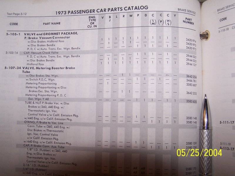

The valve for the 1973 satellite is 3642 233 from a 1973 Mopar parts book. I know your's is a 1974 but I can't find that info just yet. Could well be the same (see below) but I will keep looking for the 1974 number.
Mopar Disc Brake Proportioning Valve & Metering Valve for Disc Drum
  • Oe style mopar disc drum proportioning valve / distribution block
  • This is a metering block mounted to a proportioning valve & will fit the following applications:
  • Fits a,b,c and e bodies from 1960-74 with disc front & drum rear.
