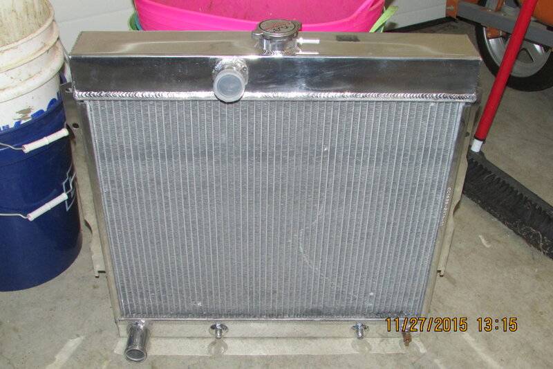

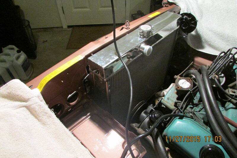

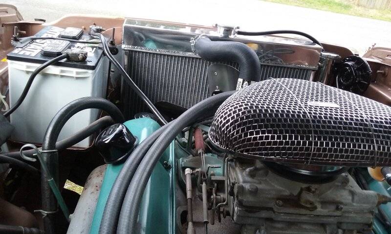

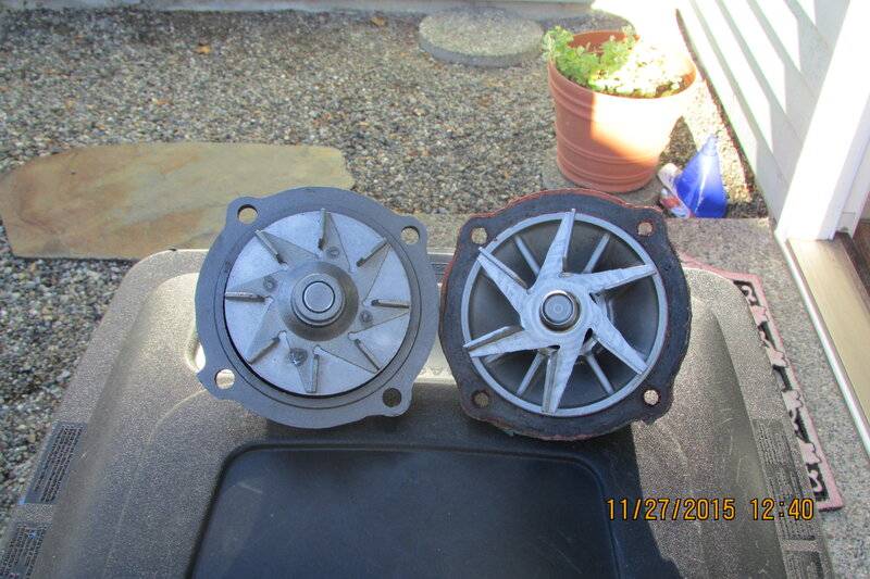

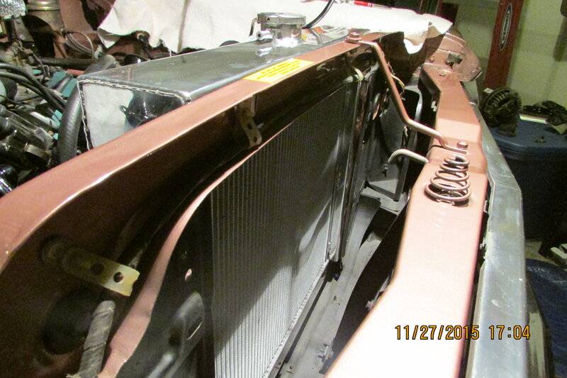

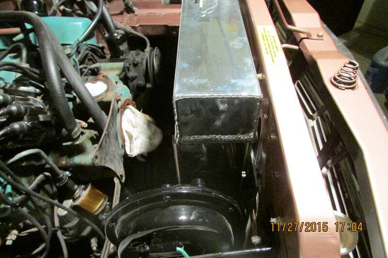

Here’s some pictures of the install on my 64 Sport Fury. If the pictures load right the 1st is the original with the fan clutch which has never been my favorite on any of my cars. There’s a picture of the water pumps hi flow versus some stock replacement. Picture of the new Champion radiator and the first look after the install. :thumbsup::luvplace::steering:

These should show how well the radiator fits and sits tight against the core support. If I remember correctly I had to grind some of the mounting flange on the left side of the radiator to clear the battery tray, but it was very minor.
