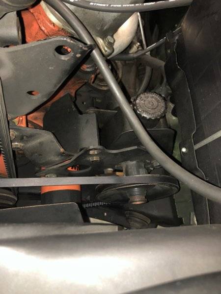

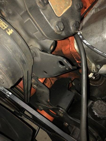

If I wanted to put in a Saginaw pump, with the keyed/nut pulley, do you think I’d need a different bracket, or will this one do?
90B430D8-95D0-44AC-AAA9-CD512327C992.jpeg CEA5BD69-B980-4442-8123-E89B34B46531.jpeg
Another option, only if it needs spacing out though, not in. Pics look like it needs to come out, but hard to be sure from a picture.

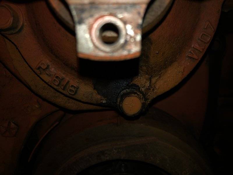

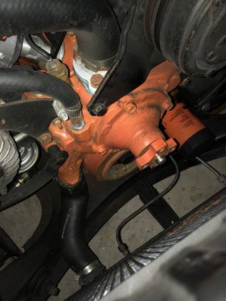

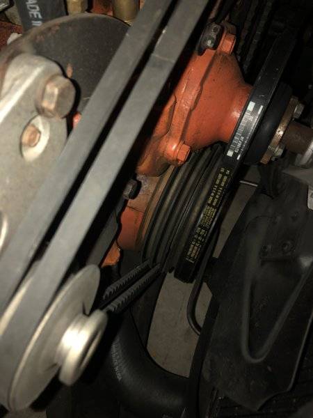

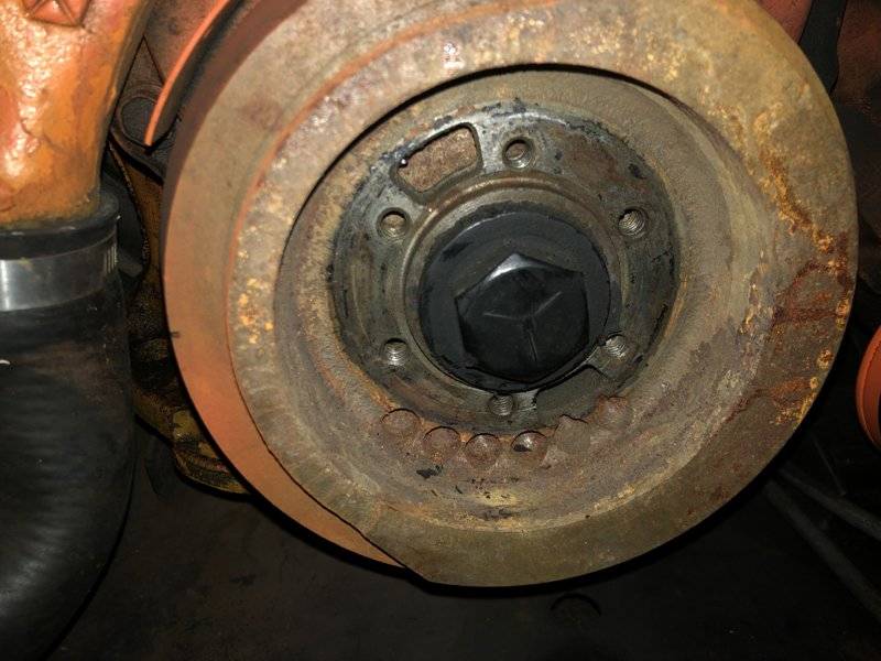

Some images of my bulletnose balancer, and the water pump. Anyone think “wrong” water pump
Could be to blame? Were there options with different flange depths? There was no noticeable run out or wobble on the WP flange
