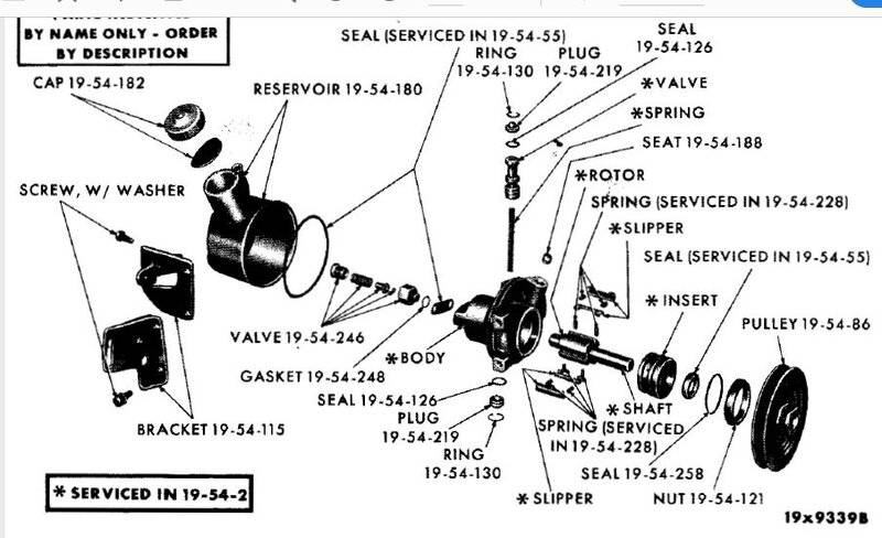

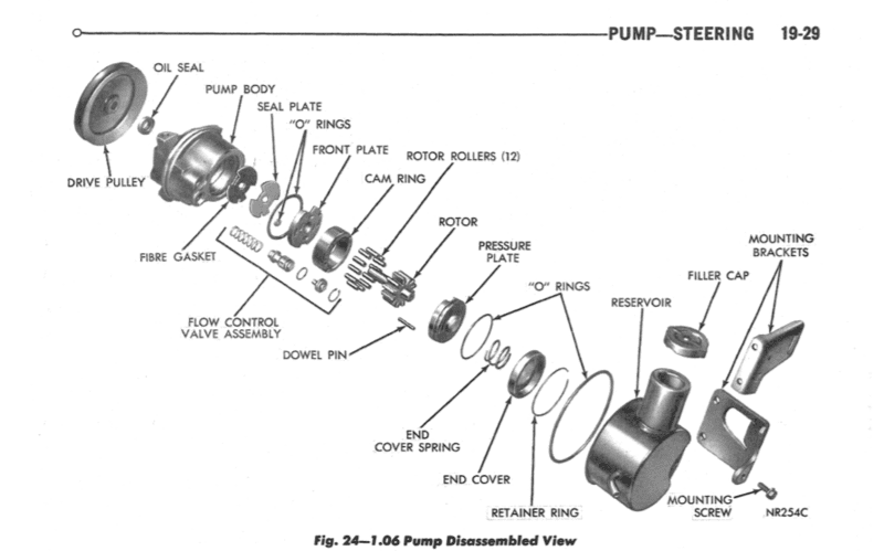

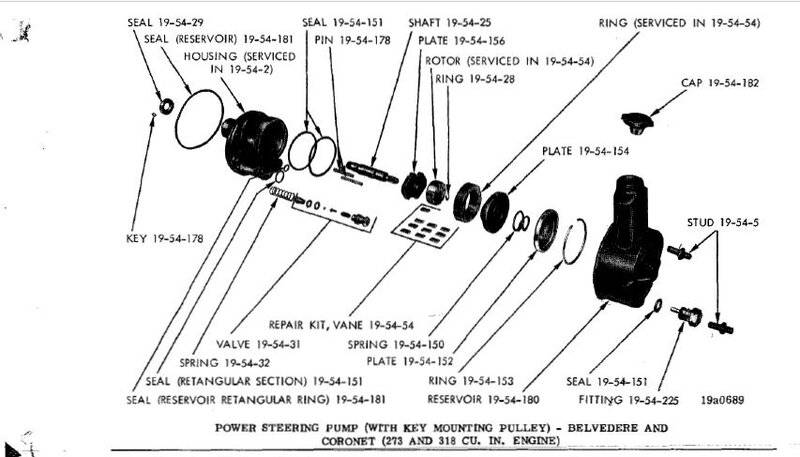

Been looking here and the net and no luck.
Thanks
Don't know this are what your looking for? Parts manual from mymopar 1966. These are the 2 pumps listed for 66.
Many thanks....
One thing, The O ring that appears to be between the front plate & the pump body.... It actually goes between the pump body & the reservoir... It seals the bolt hole that goes through the reservoir....
