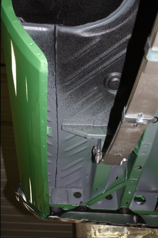

I'm trying to figure out what all the holes do in my frame. if someone has a picture from the bottom looking up at where the rear bumper and everything mounts to the frame that would be great
Best picture I have. Hope this helps.
D
DView attachment 340886
perfect, thanks for that! Do you know if the bumper goes on with nuts and bolts into the back of the frame or is it a nut welded inside the frame that a bolt threads into? I have two different frame rails and both of them are different so I'm trying to figure out which one is right

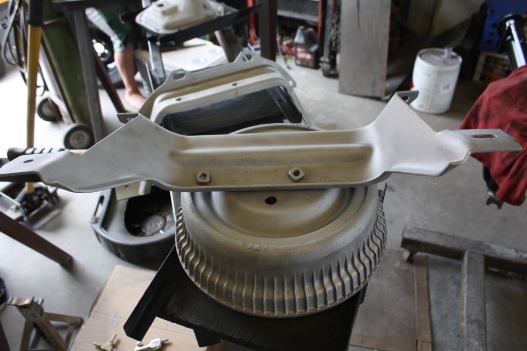

In the picture above, the right bolt has a blind nut welded inside the frame. The left is a bolt and nut. The bumper bracket face has blind nuts.
