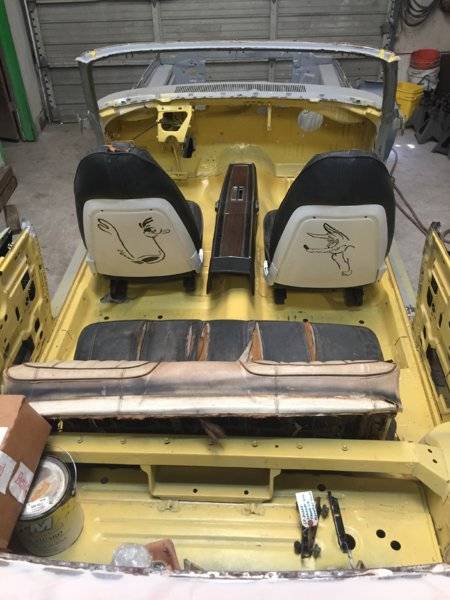

last one I did I screwed the brackets to the console, put the console in its happy place, and tacked the brackets to the floor

I did the same thing you're doing on my 70 roadrunner. I Put the tracks on the seats, set them where they needed to sit, same with the console. Little bit of being rough with the parts set the stud locations into the paint, which were drilled oversized for additional play for adjustment. Mine came out just fine.
